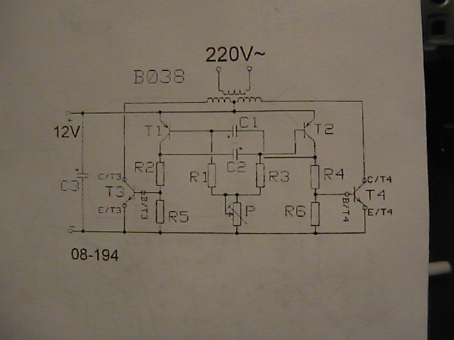

re inverter
can anyone give details on how to upgrade this schismatic for an inverter
here are the part values
T1/T2Transistores BD234
T3/T4Transistores 2N3055
C1/C2 Elkos 22uf 25v
C3 ELKO150UF 16 V
P Potentiometer 470 ohm
R2/R4 15ohm/4w
R1/R3 330 Ohm
r5/r6 560 Ohm

A guy on another forum made that "inverter" kit. Its output was about 30W, its voltage was very low and its transistors got very hot.
2000W from a 12V car battery? That is 200A! The battery will boil in a few minutes then it will melt. You will walk home.

bubbat I have designed inverters ranging from a few hundred watts all the way upto a few hundred kilowatts... and you know what they are all pretty much the same just with increase rating (and a bit more care todo with paracitics)
you say you have a 500Watt inverter... so up-rate is. I do believe TWO people told you todo that
