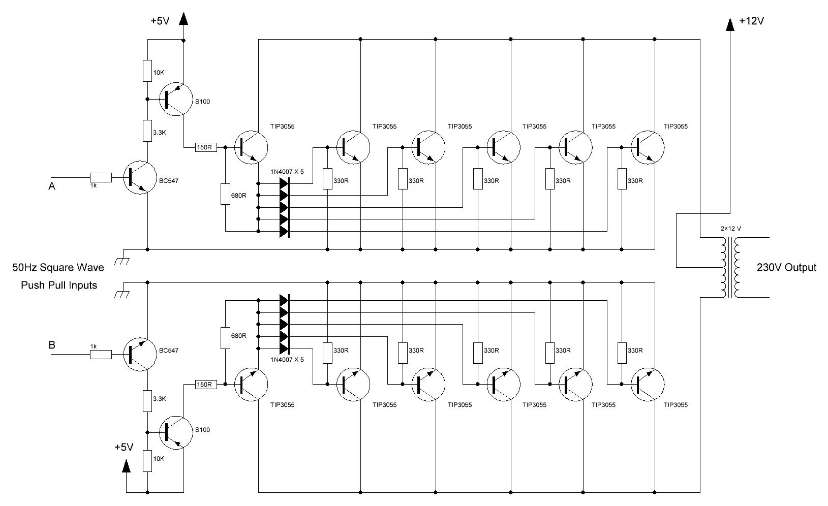

Hi I’m going to build an inverters output stage. This is my own version. I like to extend the circuit to get more kilowatts power.
This is only a BJT version later I’m going to implement a FET version as well. First I need to verify my diagram.

What are the diodes for? I've never connected a bunch of power transistors in parallel like that, but I understand it's not a very good idea becuase of current hogging. Use low value emitter resistors to mitigate that effect. Also, you're switching 12Vdirectly into the bases without anything to limit current. The transistors will just go *poof*. Why are you using obsolete 3055's? Also, the fast swiching might mean very high output voltage from your transformer, as well as high sipkes on the primary side.

Ok I'm going to use 0.22Ohms/5W emitter resistors on the output transistors.So I need 10 resistors.
Is it ok if I replace the diodes & connect 1K resistors?
Can you suggest a transistor which is commonly available? TIP3055 is very easy to find.

You don't seem to have any snubber network on the transformer primary,ie large back EMF with switching!without anything here,your tip3055's will blow.;)
You would probably be best off revising the switching circuit to use a Mosfet based design. Then all you would need is a gate driver IC to run each bank. You would have much higher power capacity and greater efficiency for less cost as well.
But 10 Kw at 12 volts is somewhat unrealistic being the amps are incredibly high at that level which makes all of the power handleing cables massive.
Yes, 500W is about as high as 12V can go really, for 10KW the massive banks of batteries may as well be wired to give a MUCH higher voltage - in fact why not wire them to give 120V or 240V, so no need for a transformer?.
Also, what use is 10KW of squarewave?, a class-D sinewave switcher directly off batteries (no transformer or inverter again) would give you a nice sinewave.

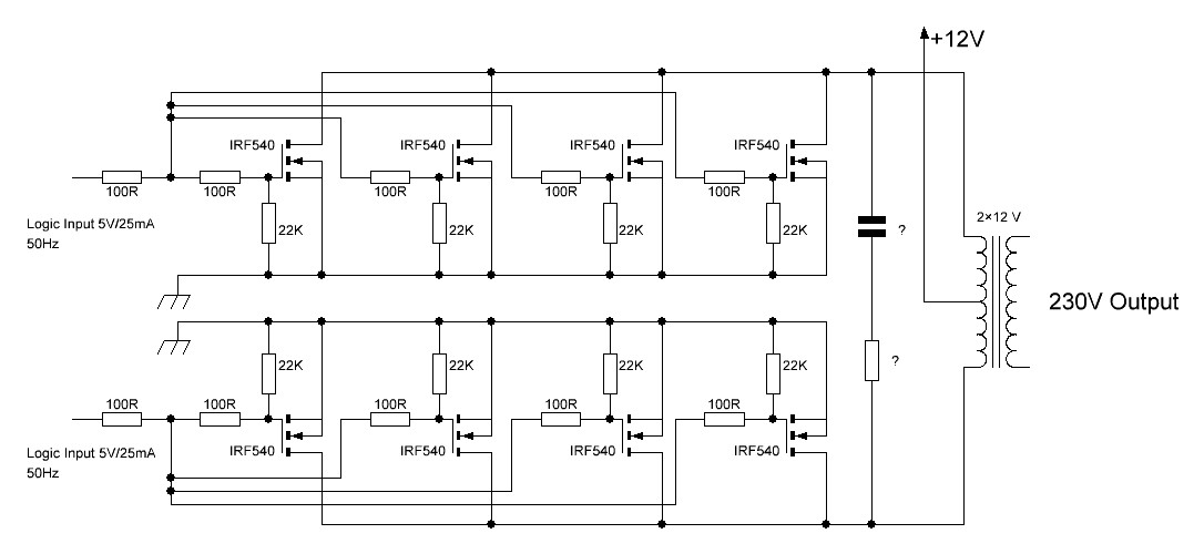

Ok guys I finally planned to make a 12V 500W inverter.
I'm going to use MOSFETS.IRF 540 ones.Any suggestions!!

Ok this is the circuit I'm going to make.Is my values ok? What about snubber values??Is this is a good design?

A simple square-wave inverter has the peak voltage the same as the RMS voltage of a sine-wave so that the power is the same to a heater or incandescent light bulb.
A modified sine-wave inverter (really a modified square-wave) has the peak voltage the same as the peak voltage of a sine-wave so the transformer low voltage windings must be 8.5V instead of 12V. Then the peak current is 1.4 times higher than a square-wave inverter.
A CD4047 oscillator has 3 outputs which can be gated to make the modified waveform.
Ok thanks audioguru now I understood.So I'll change the transformer to 8.5V-0-8.5V.If I cannot find a 8.5V transformer is it ok a 12V-0-12V one?
I need to verify my values & the most important thing is that snubber values.
Why not use a 9-0-9V transformer which you should be able to buy?
If you use a 12V + 12V transformer in a modified sine-wave inverter then the output voltage will be only 163VAC instead of 230VAC.
Your inverter is extremely simple and does not heave voltage regulation so the output voltage will be higher than you expect when it has a light load and the battery is fully charged and the output voltage will be lower than you expect when the load is heavy and the battery charge is running down.

If you use a 12V-0V-12V transformer then the peak voltage of your modified sine-wave will be 230VAC but the RMS voltage will be 230V x 0.707= 163VAC.
If you use a 8.5V-0V-8.5V transformer and feed it with a 12V peak modified sine-wave then the peak output voltage will be 325VAC and the RMS will be 230VAC.
