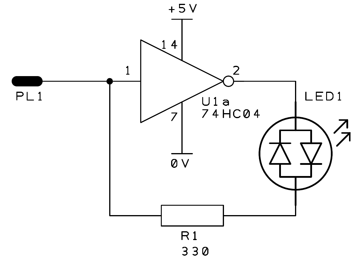

I came up with a simple idea for indicator lights for breadboarding purposes - connect a bi-directional, 2 colour LED (or two LED's in anti-parallel) and it's limiting resistor from the output to the input of an inverter. The assumption is that the DUT can sink or source the LED current, so one or the other lights depending on the polarity of the input, and the inverter provides the return path.
So the only thing I'm concerned about with this is, what happens when there is no input? There's no adequate current path to light either LED, but would the circuit oscillate? If so, what will prevent it?
DUT connects to PL1.
It would probably oscillate with no input. The LEDs will have capacitance, so it could lead to high frequency oscillation.
With a 3 V supply, the input threshold voltage would be around 1.5 V. The input could sit a bit below that, so the output is high, without any current flowing in the LED, so it might be stable in that condition.
Also, with no input connection, the LEDs may generate voltage from ambient light, so the behaviour may depend on the ambient lighting.
I would suggest that you put another inverter between the DUT and PL1, and then you can put a high value resistor between the input and ground to stop it oscillation if the DUT is open.
That was my first thought too. But then I lose the open input = no lights condition. Or am I missing something?
I was going to say ambient light voltages would cancel out, but then the LEDs are different colours so they won't completely... Never even occurred to me, that one!

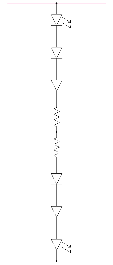

If you want open input = no lights, I suggest this circuit:-
You can adjust the number of diodes depending on the supply voltage so that the total voltage of the LEDs and the diodes add up to more than the supply voltage, and with a floating input, no current will flow.

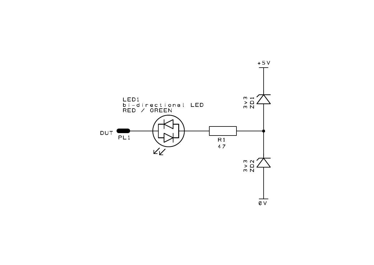

Ah, the old classic, improved! But I need to change it a bit so I can use my funky bi-directional, bi-colour LED's that I haven't got yet! So putting that in series with the input instead of each end of the PD will do the job. It's only ever expected to run on 5v so I can put 3v zeners in for the diodes.

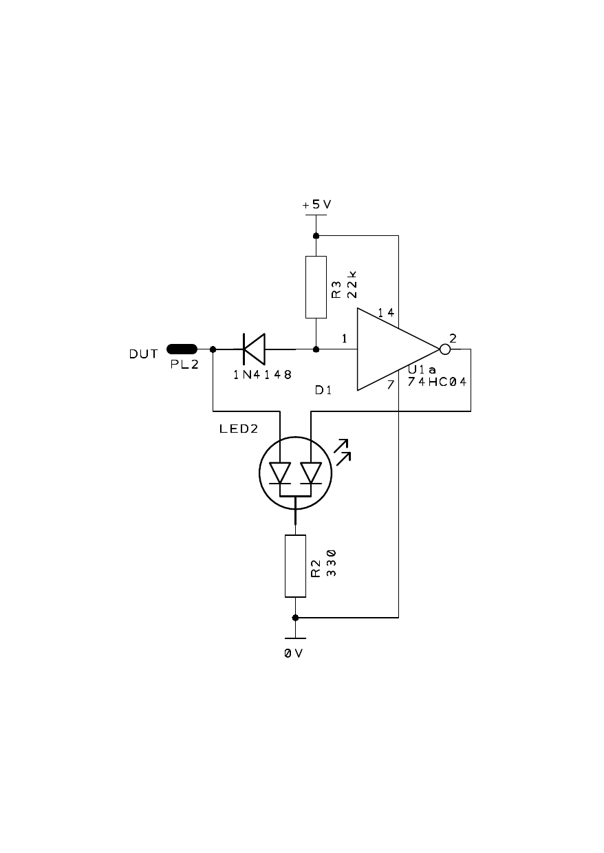

Right, so a variant of the inverter based version which would actually give me a tri-state indication. This is the most complex I'm prepared to go with it. Also these LEDs seem to be a bit cheaper than the 2 pin dual ones. (I already have more 74HC04 than I will ever need)
i've just realised, that's not going to do what I want, is it? Damn.
