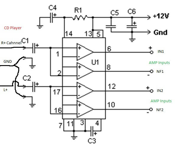

Hi everyone. I was wondering if it is possible to connect a chipamp such as the TA8205AH to the same PSU that is powering the source. Let's say you connect the amp to a PC's 12V rail and you connect the Inputs to the soundcard's output (R, L & GND) - then you'll actually be shorting the V- input to the ground, right? So is there a way to connect this chip on the same power source as the input? With what circuit can this be done or can someone explain me what can be done and what will be the best option because I'm stuck on this one. It should be possible because the use these chips in car radios and the car has only one battery to power both the radio and the amp (all-inside-one unit). Help or guidance would be appreciated.

That's correct - you won't find that on the datasheet??? I don't think you completely understand me. The V- and V+ are the inverting inputs and should NEVER be connected to the ground. My problem is I'm using the same PSU for the application supplying the audio input {the audio source doesn't have inverting outputs} and the amp itself {which has inverting inputs}. I really don't know how to say this differently... I can't connect the source {which has a R+, L+ & a GND} to an inverting amp that uses the same PSU or battery as the Audio source {cd-Player}. If I connect the GND of the Audio source {the GND of the Audio Source is connected to a battery's GND pole} to the V- of the AMP, then indirectly I'm shorting the V- of the amp to the GND. Savvy?
I'll draw a picture and post it... Maybe it will be clearer than my words as I'm not actually English.
The stereo signals connect to the input capacitors of the amplifier and the ground of the stereo signals connects to the ground of the amplifier.
The inverting inputs of the amplifier are connected to ground with capacitors so their DC voltages are not changed.
I have connected the stereo signals to the 2x C1 capacitors in the schematic, that's correct {IN1 and IN2 in schematic}. I can't connect the GND from the audio {which is the same as the GND of the PSU + amp} to the GND of the amp - it will send 6V to the speakers.
Yes, there are capacitors on NF1 & NF2 + GND, but I can't connect the GND from the CD-Player to the amp's GND because it sends 6V to my speakers.
In the previous picture I've accidentally connected the GND of the audio to the Ripple of the amp. Here's a new picture.

Why would you want to? - the datasheet clearly shows how to use the IC - just follow that, you only connect to the two inputs and the common ground, you don't connect anything to the inverting inputs except the two capacitors shown (why would you think you should?).
I think you're used to the LM3886 type of amp which uses a center tapped transformer. It doesn't support bi-directional audio, so the Bass isn't so good, it's just Good, not Excelent. The way you want me to connect the TA8205AH amp won't work. I've tested it already and I can confirm the GND of the amp is not for audio, it will cause the amp to play the speaker in only one direction. The speaker is also not connected to the GND. Channel 1 uses IN1 and NF1 for audio input and OUT1 & OUT2 for the output. I don't see the part in the datasheet saying I should connect the amp to the GND. I'm actually using the amp like the datasheet says. IN1 + NF1 for input.

For the third or fourth time - USE THE CIRCUIT AS SHOWN ON THE DATASHEET - that's all that's needed, and your silly pointless schemes probably wouldn't work anyway.
For the 100th time. You don't understand what I'm asking. I've already built the amp, I just don't know how to connect it's inputs to the CD-Player's output. there's nothing in the diagram on how to do that...
Of course there is - page 7/11 on the datasheet - two C1 capacitors at the left, the inputs go in there.You obviously need a common ground as well, and that would (again obviously) be pins 5, 13, 14 and tab.

The ground from your CD player must be connected to the ground of the power amplifier, not to the NF1 and NF2 inputs.
All the inputs of the power amplifier have capacitors because they are all at +6VDC. All the outputs are also at +6VDC then the speakers have 0V across them.
Why do you talk about V-? There is no V-. The amplifier is powered from +12V and ground.
Repeat: NF1 and NF2 are not inputs. They are connected to ground with capacitors so that the amplifier has a DC gain of 1 and as much AC gain as shown on the datasheet.
