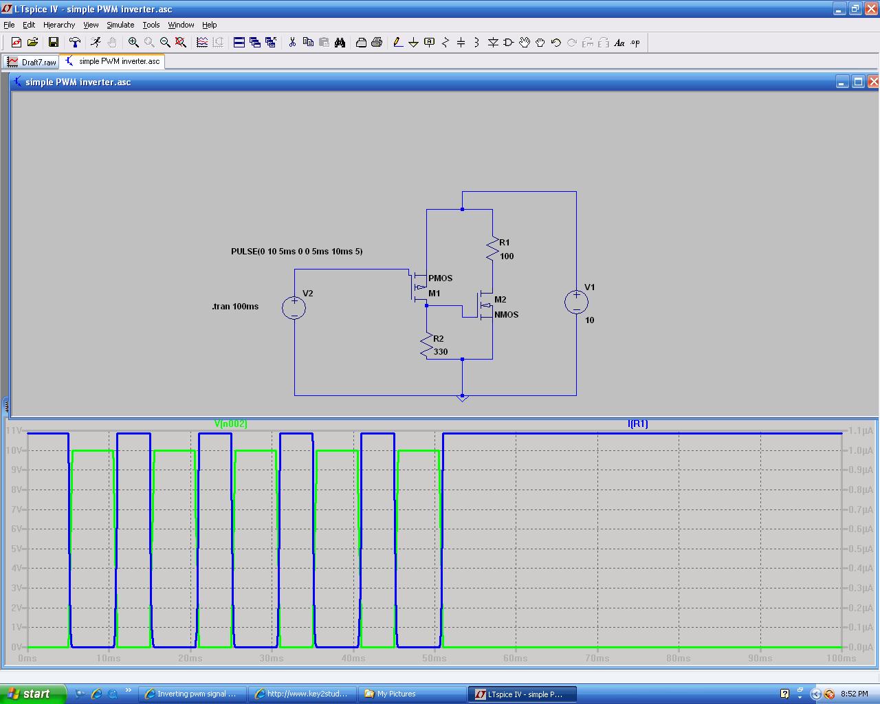

Anyway to recap, running my original circuit on the first page in proteus, when the earth switch is connected (as it would be when the duty is high) I get 0v between the 12v feed and the output earth of the load (the lamp). The lamp stays off.
When this is inverted, and the earth is disconnected (the switch is open, representing the mosfet controlling the earth connection in the ecu is at logic 0) then my mosfet pulls high and the lamp comes on.
true, at 10v not 12v, but it does do the opposite of the input. Which might be why I took the critisism so badly. I don't mind being called an idiot, but it goes down much better when my solution isn't the closest one to a working outcome.
I was expecting to be told something wasn't right with it however, I am NOT a mosfet expert, and the whole point of posting the circuit was for feedbacks sake.
I do appreciate the feedback received, there are good people on here.
You're not achieving inversion, because the lamp is off when the input to your MOSFET is low, and on when it is high. That's simply a voltage follower, not an inverter. Look at the attached circuit. When the input from the left side voltage source is "High", the current through R1 ( your lamp ) is zero, and visa-versa. This is an inverter, and it's at least a representation of what you want. We just need to make sure the voltages, currents and loads are correct, and make sure we have proper FET's. Also, you'll need to protect the circuit against load dumps.

Lets recap:
On the left of the red line we have the outputs of the ecu, one fixed 12v feed and a switched earth. Obviously proteus doesn't have an 'ecu module' so I simulated it with a permanent live and an earth. With a switch.
It's basic but at an electrical level it's the same thing, i just have to flick the switch really fast ;)
Inbetween the red and blue we have my mosfet, with that resistor. Now in the original circuit, thats where my solenoid would be. Instead we have a resistor in it's place which pulls the gate high when the earth is disconnected.
We also have the mosfet conencted to the 12v supply at the top, so that when the gate goes high, current flows.
So you see, in concept it works. When earth switch is off (open), gate is on.
Audioguru actually came within a millimeter of solving my problem whilst he was calling me thick, because he mentioned swapping source to drain (I cant remember what he said exactly) and I misunderstood this instruction as I thought he meant just flipping the mosfet and I knew from my past knowledge this not to be.
It's only two seconds ago that I positioned the load on the other side of the mosfet that I realised the whole problem with my circuit was an amateur cockup, and a result of me not concentrating and putting the mosfet on the wrong side of the load (lamp).
Therefore audioguru, despite all the ill feelings, does deserve the credit of being the person who had the right idea. I think it could have gone without the ill feelings, but I insist on being fair with the good aswell as the bad, so thanks. I do think you're an arsehole but thanks. You've had chance to say what you think, that was mine. We are even and this is done with.
Your suggestion too is appreciated though, this three page thread really is about the placement of a mosfet. I think we've all earned the right to feel daft. It is after all a basic circuit, and as far as placing mosfets goes it's one I've done before.
As far as this thread goes, my solution that I drafted myself was good, the circuit was no-one elses suggestion, I never really understood what audioguru was raving about, but now I've fixed the problem myself by realising my cockup maybe I can. I assume he was trying to get me to look at that but between all the tripe I never got the message. But I sorted it. And I am content with myself.
Interesting though that the circuit itself did 90% work despite the faulty placement.

Your N-channel Mosfet is a follower. Since its gate-source voltage must be at least 5V for it to completely turn on then its max output voltage at its source pin will be about only 7V.
If the load is between the positive supply and the drain pin of the Mosfet then the load will get the full 12V but the logic will be inverted.
With the addition of many level-shifting parts the load will get a swing of 12V when driven from a P-channel Mosfet. But then the load must be disconnected from ground and connected to +12V instead.
It won't actually be inverted, because the load ( lamp or solonoid ) will be "on" when the input is high, and "off" when the input is low. That's why my circuit uses two FET's.
guru...u are assuming a logic level MOSFET?
It is very difficult to read the tiny scribbles on the schematic but it looks like an old logic-level IRL540 Mosfet.
