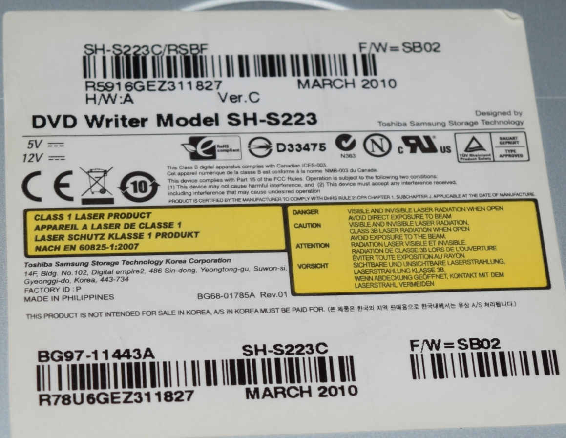

Recently, I opened up a DVD writer drive for curiosity to see its insides and mechanisms. While the drive casing was open, I plugged SATA power and signal cables to it to see it in action (opening and closing the tray while the laser/lens unit is trying to check if a valid disk is inserted or the first few seconds that the lens unit moves on the rail with the spindle spinning). Although I knew the visible laser beam is bad for the eyes if viewed directly, but I didn't know anything about "Invisible laser radiation". Sounds like they use not just on laser diode in the drives.

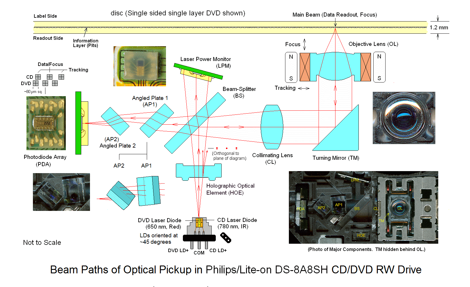

Now besides a little worry about if I damaged my eyes (though I never looked at the lens and laser, just viewed it from the rear), I wonder where does the invisible beam come from and what's the purpose of it? Do they come from those rounded rectangular holes that I depicted in the album below? What are they?

Probably no danger. The device is clearly labeled "Class 1". Here's Wikipedia's definition:
Wikipedia said:
CLASS 1 LASER PRODUCT
A Class 1 laser is safe under all conditions of normal use. This means the maximum permissible exposure (MPE) cannot be exceeded when viewing a laser with the naked eye or with the aid of typical magnifying optics (e.g. telescope or microscope). To verify compliance, the standard specifies the aperture and distance corresponding to the naked eye, a typical telescope viewing a collimated beam, and a typical microscope viewing a divergent beam. It is important to realize that certain lasers classified as Class 1 may still pose a hazard when viewed with a telescope or microscope of sufficiently large aperture. For example, a high-power laser with a very large collimated beam or very highly divergent beam may be classified as Class 1 if the power that passes through the apertures defined in the standard is less than the AEL for Class 1; however, an unsafe power level may be collected by a magnifying optic with larger aperture.
As for the invisible part, it could be some IR tracking diode. Apparently, 780 nm was used in the past according to several source. Now they seem to be 650 nm (red) or 405 nm (near UV).
John
John
Yes, but on the right side, it is written "CAUTION VISIBLE AND INVISIBLE LASER RADIATION, CLASS 3B LASER RADIATION WHEN OPEN."

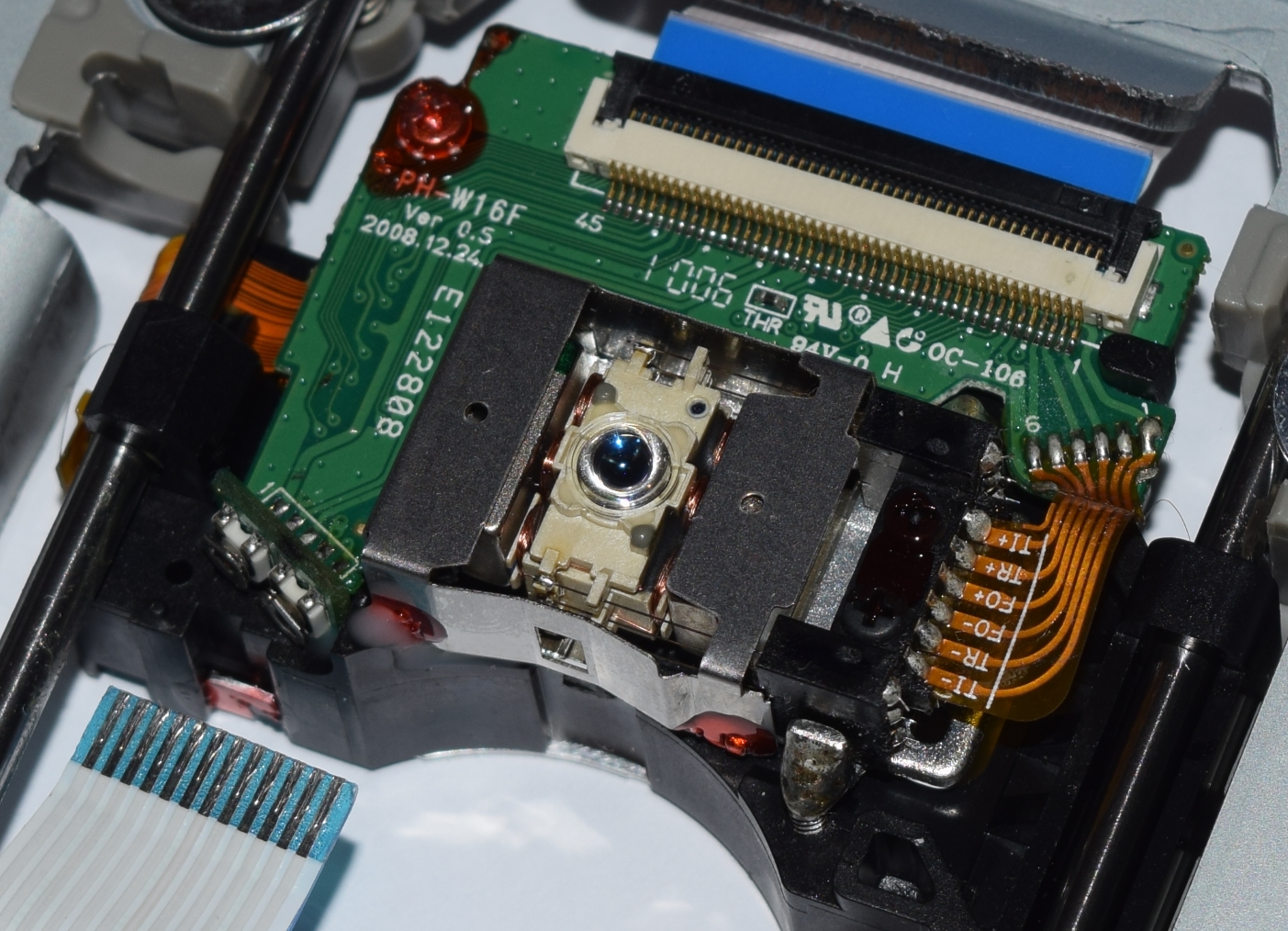

Where's that IR diode and what are those holes that I used two red arrows pointing to them in picture #2?

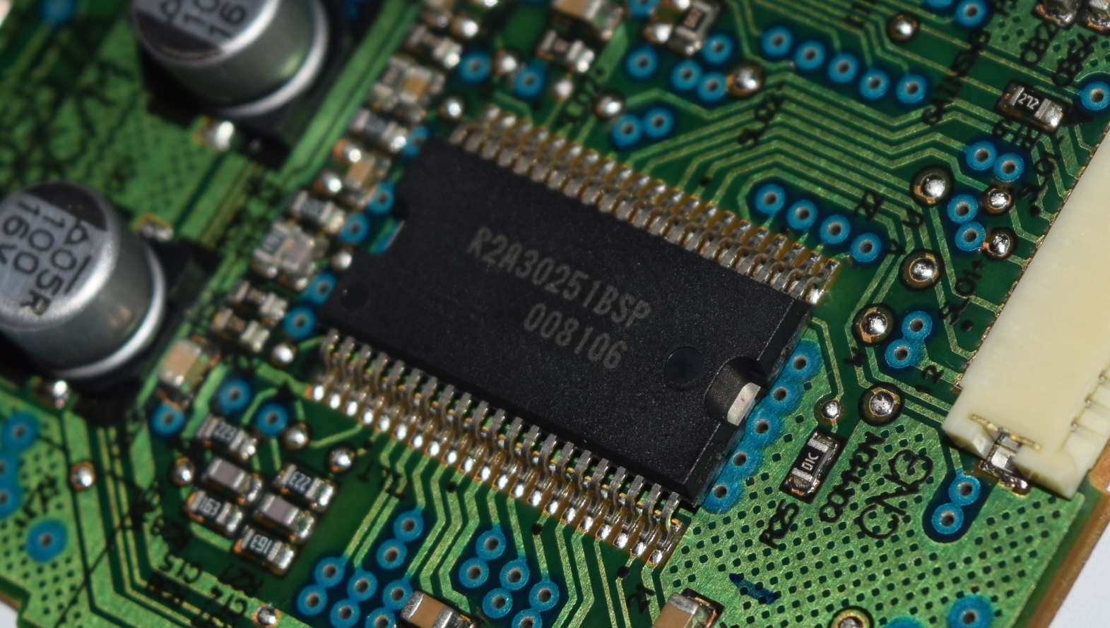

All laser radiation is emitted at the bluish lens centered in picture 1. Those holes at picture 2 should be the prismatic mirrors. The radiation usually is emitted when there is a disc inserted for reading it or in higher power, for recording onto it. The laser diode is the one in picture 3 connected to pads labeled CD/GND/DVD.

What was the need to make holes for those mirrors?

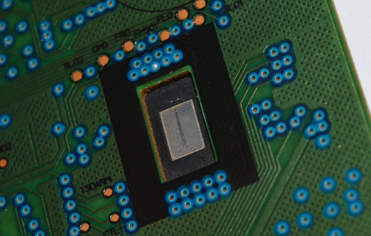

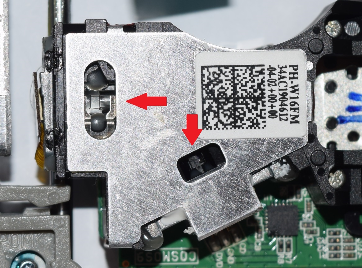

I'm also curious to know what's the 5th picture? It belongs to the chip in picture #4. Is it some kind of heat anticipator?

Picture 5 is the belly of IC in picture 4 ; it could provide heat dissipation when certain application needs it by attaching a heat sink surface there.
