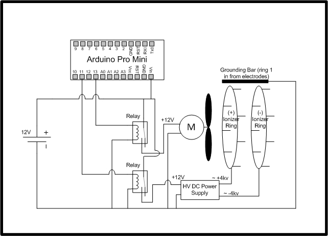

I'm attaching the circuit for your review. Please excuse how amateurish I'm sure it is. One thing I'm not sure on, is if I need any diodes, resistors, etc in the circuit, and exactly where the decouplers would go. I appreciate any feedback on the circuit.

I don't like the idea of driving relays directly from the Arduino pins. I'd add transistor drivers for the relays, plus reverse-biased diodes across the relay coils for back-emf protection.
I can do that, but would this work as an off-the-shelf solution: **broken link removed**
It seems to have some diodes on it, although I'm not sure if they're for back-emf protection
Also, using the power supply I've provided the datasheet for on the top, is there anything I should add around that portion of the circuit?
If that relay module is a tried-and-tested device it's reasonable to assume it has back-emf protection; otherwise the seller would have a lot of annoyed customers :). The relay ratings look ok for switching a small 12V fan.
The one I looked at indetail uses 12v dc, and a full bridge to switch that into the bottom of a voltage multiplier, I expected high voltage into the base but its low voltage dc.
You could put some arc suppression across the relay contacts, assuming they are mechanical contacts, a 100 ohm and a 100nf class x, you can get proper suppressors with those 2 built in.

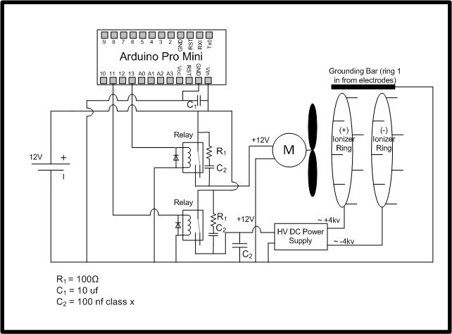

I've attached a revised drawing based on your comments. I'm not sure about the decoupling capacitor values, or if there's anywhere else I should place them.
Pepper - I'll look at the dc voltage multiplier option - that maybe a better route.
Please let me know if anything is incorrect (very likely) or if there's anything else I should add.

Looks ok initially, you'd have to see if theres any trouble when running it.
