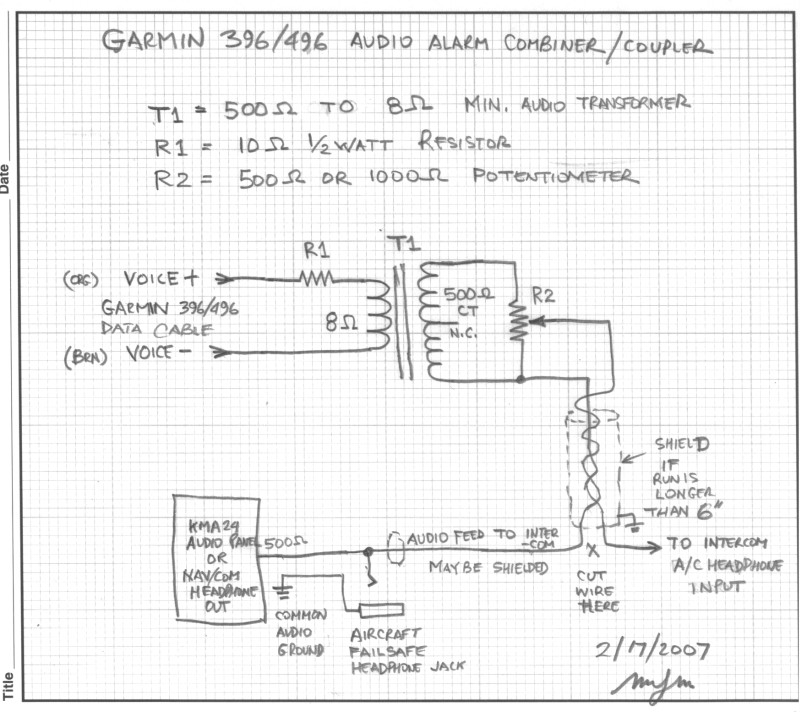

I'm trying to make what should be a simple circuit. It will be used to attach an aviation headset, and an iPod at the same time. So that I can listen to tunes and hear radio transmissions.

I was thinking I should wire in diodes on the iPod line and also the line from the airplane. So current only travels from iPod, and from airplane, then both travel to headset. This to prevent damage to either one.

Just a quick update. I built an adapter 1/4male that plugs into airplane. It is wired into a box that splits into female 1/8" plug(iPod) and a female 1/4" plug(headset). When only one audio source is played, ie iPod, or airplane radios, the audio sounds great. But when I turn them both on the volume is greatly reduced. The iPod audio still sounds great, however the airplane gets distorted if I turn its volume over half way. Any ideas??

I have listened to the iPod with my aviation headset, and it sounds great! The configuration I have set up now does not affect the other pilots audio, so we are good there. Just as you suspected the aircraft audio is distorted ONLY when the iPod is plugged in and audio is playing. Would your suggestion, "Can you find a small audio coupling transformer with 10 to 30 Ohms on one side; and 100 to 500 Ohms on the other?", possibly solve the distortion problem by bringing the ipod resistance up to a comparable level with the airplane?

Maybe this will give an idea. Two transformers, one for each channel. Put them in the box between the aircraft jack, and where you plug your aviation headset.
