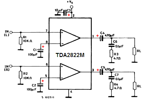

If your capacitors are connected with the correct polarity in the circuit shown in the datasheet of the TDA2822M and using the pcb layout shown in the datasheet and if the battery voltage is 4V to 7V then the amplifier should work fine.
But since you did not post your schematic here then we do not know what you have done.

i have used the circuit shown on the data sheet "test circuit (stereo)" http://www.datasheetcatalog.org/datasheet/stmicroelectronics/1464.pdf

The amplifiers might oscillate if you do not make them on a compact pcb with a layout like shown in the datasheet.
ST Micro show capacitors with an open line for the positive terminal and a closed line for the negative terminal.
Tantalum capacitors have the positive terminal marked with a "+" sign. Electrolytic capacitors used to be marked the same and are shown with the positive terminal marked with a "+" sign on schematics but newer ones have an arrow pointing to the negative terminal.
I marked the positive terminal on each capacitor for the stereo amplifier.

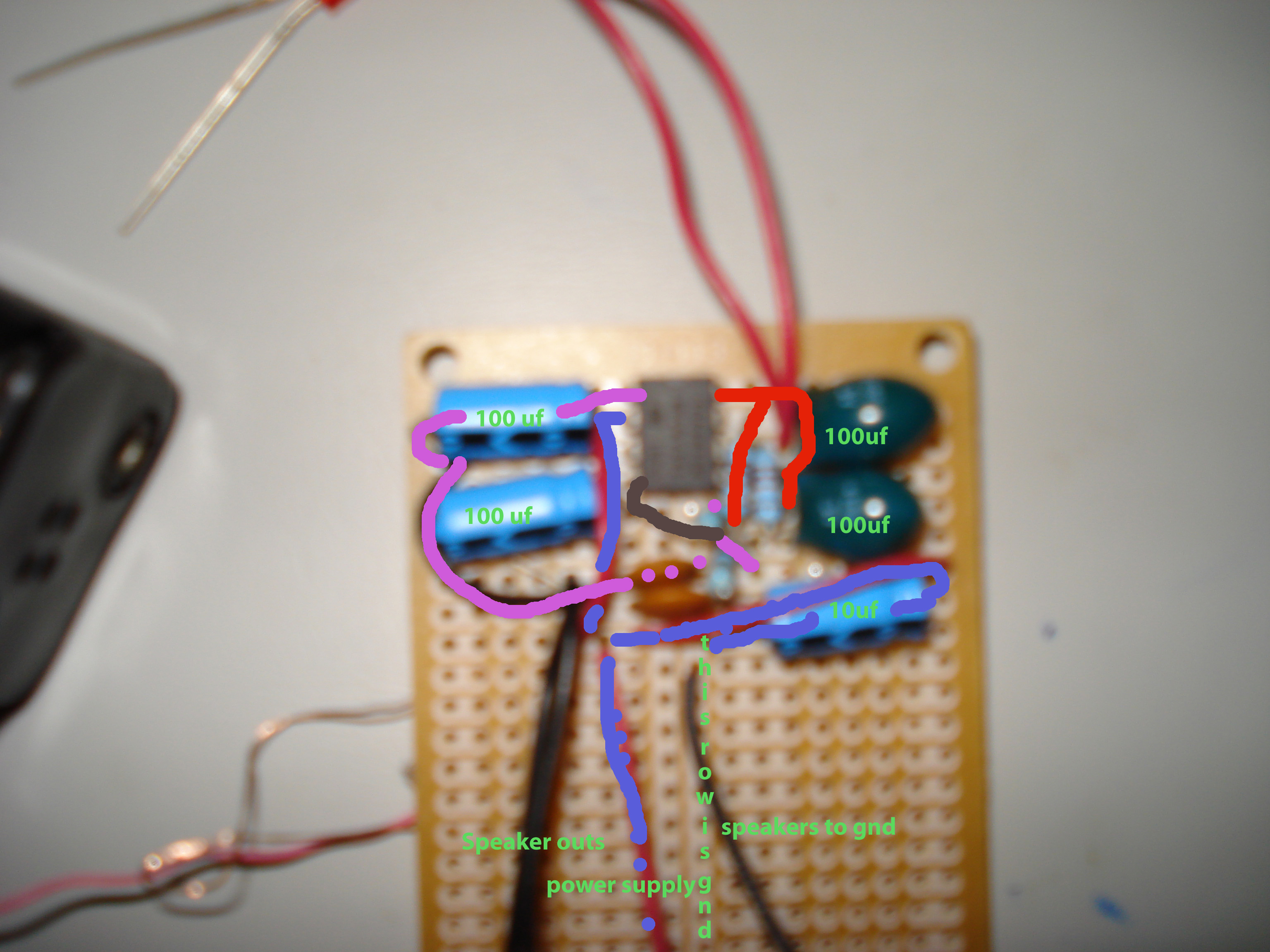

Here is a picture i took of the amp. I traced a couple of branches to make them easier to make sense of. Can you see any flaws?
The camera on your cell phone is so bad that I cannot see anything on the photo.
If your speakers are 8 ohms then the very small value of the 100uf output capacitors cuts all bass frequencies below 200Hz.

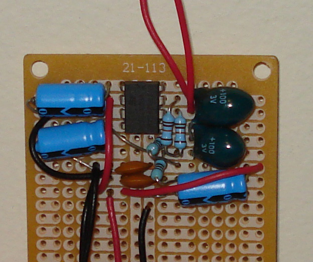

i dont actually know the resistance of the speakers as like i said the multimeter is broken and they are unmarked because they're salvaged from an old vaio. How would i prevent the mangling of my tunes? here's a better quality picture.

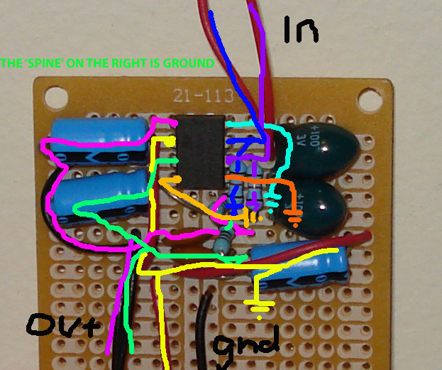

The photo is much better but I still I cannot see how you wired the perf board.
heres the better quality pic with wiring marked
I cannot see what is connected to what.
For such a simple circuit I do not understand why you have wires crossed and all over the place.
i cant really show you any clearer. I'll show my physics teacher tomorrow and hopefully he'll be able to identify the problem. All the bridges are due to size limitations and the lack of a pcb. I saw a method of making pcb's on the forum so i'll look into that.
