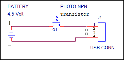

Hello everyone,
I'm trying to put together a remote for my camera using the CHDK, (you can look up "CHDK USB Remote" for more information).
Basically, I want to take the normal design (a battery, switch and a USB plug) and make it wireless by replacing the push switch with an infrared detector of some sort and to be able to activate it with an IR LED, so that current flows through the circuit while the LED is on, and when I turn it off, current stops flowing.
What is the simplest way to go about this?

you could use something as simple as these
If I were to use a pair like that, how would I include it in the circuit. Would I simply substitute the switch for the photodiode (which is what it is according to the page) and it would let current through if there was IR radiation above a certain threshold?

OK, rather that use a manufactured remote you have a few options. Attached is an image (very rough image) of using a photo transistor. The transistor replaces the switch as seen in your original link.
Also an IR system could be incorporated and set up similar as to the IR receiver side.
The biggest problem with using light to trigger anything or IR is the ambient light. The beginnings of solving this problem can be as simple as shielding the receiver with some black tube stock to more complex methods. Then things get more complicated. A good example is the remote control used with electronic devices where it is not as simple as a simple IR transmitter with a battery. However, in systems like this, ambient light becomes less of a problem.
What you are trying to do is not quite as easy as it looks on the surface.
