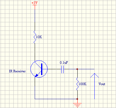

Hi, sorry for disappear for a while as I am playing around with pwm + IR sensor... I managed to increase the range of my IR emitter to around 20cm. Thanks guys for your help!! But now new problem arise... when I connect my simple RC high pass filter to the output of receiver, it seems like I get zero voltage from it...

It looks like the transistor is an IR receiver circuit or is a photo-transistor and he is trying to get an output from its input or its base.

Well the transistor seems liking in any kind of biasing, but why do you want a high pass filter?.
Because I operate the pwm with the frequency of 38kHz... as I hope can reduce some ambient light effect by doing so.
Yearp... I am using some normal photo-transistor as the receiver.

Why not use a proper IC for it?, that's the whole point of using 38KHz modulation.
The range of your IR distance sensor is only 1/50th of what it could be.
1) You are using an ordinary photo-transistor that is sensitive to visible light. Visible light makes it saturate then it doesn't detect anymore. You should use an IR photo-detector that has a physical filter for reducing visible light.
2) Your photo-transistor is used backwards. You are using its base (its input) as an output. The collector is supposed to be the output then it should have a 38kHz bandpass filter and a high gain amplifier.
I don't know the circuit of your transmitter and the circuit of the rest of your receiver.
