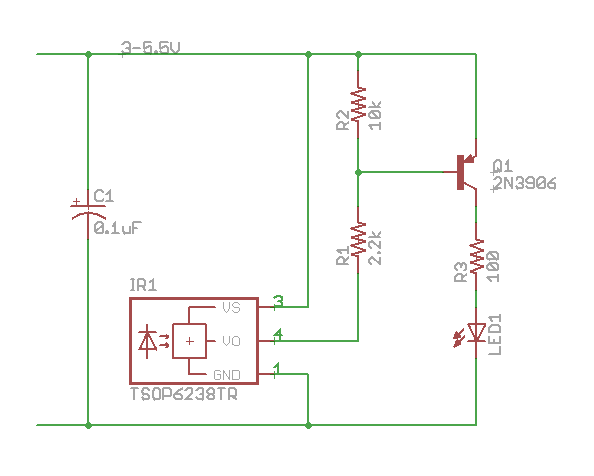

I don't know if this is any better, but for the price it might be worth a try.
[edit] I see a legend on the PC board suggesting a test distance of 5cm. If that's the case it wouldn't be very good. [/edit]
Tis TSOP6238TR IR Receiver Module for Remote Controls (Vishay)-The Electronic Goldmine should receive IR transmissions. The following circuit should amplify the output so it can drive a reasonably bright LED.
Note that the TSOP6238's voltage is supposed to be 2.7 to 5.5V so the ideal supply is 3xAAA batteries, and 9V is definitely out. Any lower than 4V and the LED might not light (depending on color). If you use red, most would work on a 3V supply.

I think the problem with the extremely simple IR detector is that many remote controls blast a very high current into their IR LRDs but the current is on for a very short duration for each pulse. The simple detector will light its LED for very short duration low current pulses which make its LED very dim.
The detector needs a peak detector circuit that charges a capacitor to the peak voltage of the pulses then slowly discharges while lighting its LED continuously.
