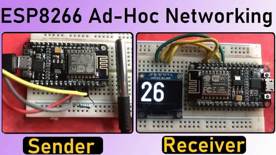

An network made out of esp8266's.
Mesh Network :
Regards, Dana.
Mesh Network :
Regards, Dana.
i see what this is , but how do you see it helping me ? i guess i don't understand where it fits into the solution.
An esp8266 is a RF module that with the links I showed indicate ease
which one can easily transmit a message to multiple esp8266 remotes.
But I think your experience level would be a challenge, even though one of these
projects can be prototyped in ~ 15 minutes working one to one, and using a web
published project from one to many.
You can buy ESP8266 modules with relays on them for this purpose.
But if electronics is a foreign language for you I would just keep shopping around until
you find someone that has done this on a product based solution.
To see whats involved :
Regards, Dana.
Rehards, Dana.
