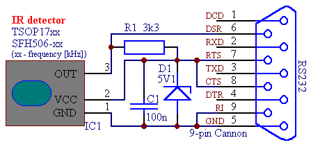

Hi guys,
I'm planning on making an RS232-interface IR receiver to use with LIRC on my home media server, but my usual electronics supplier doesn't seem to have the IR receiver IC required by the schematic I found online.
Does anyone know where I might be able to obtain an SFH506 or TSOP17 chip, preferrably a UK supplier?
I've attached the schematic for the device.
Thanks in advance for any help.

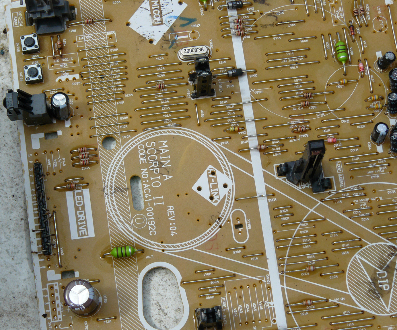

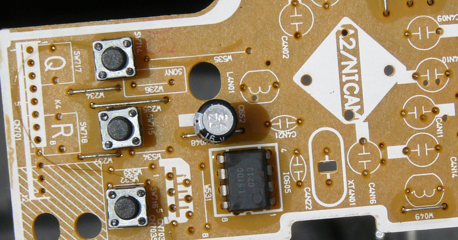

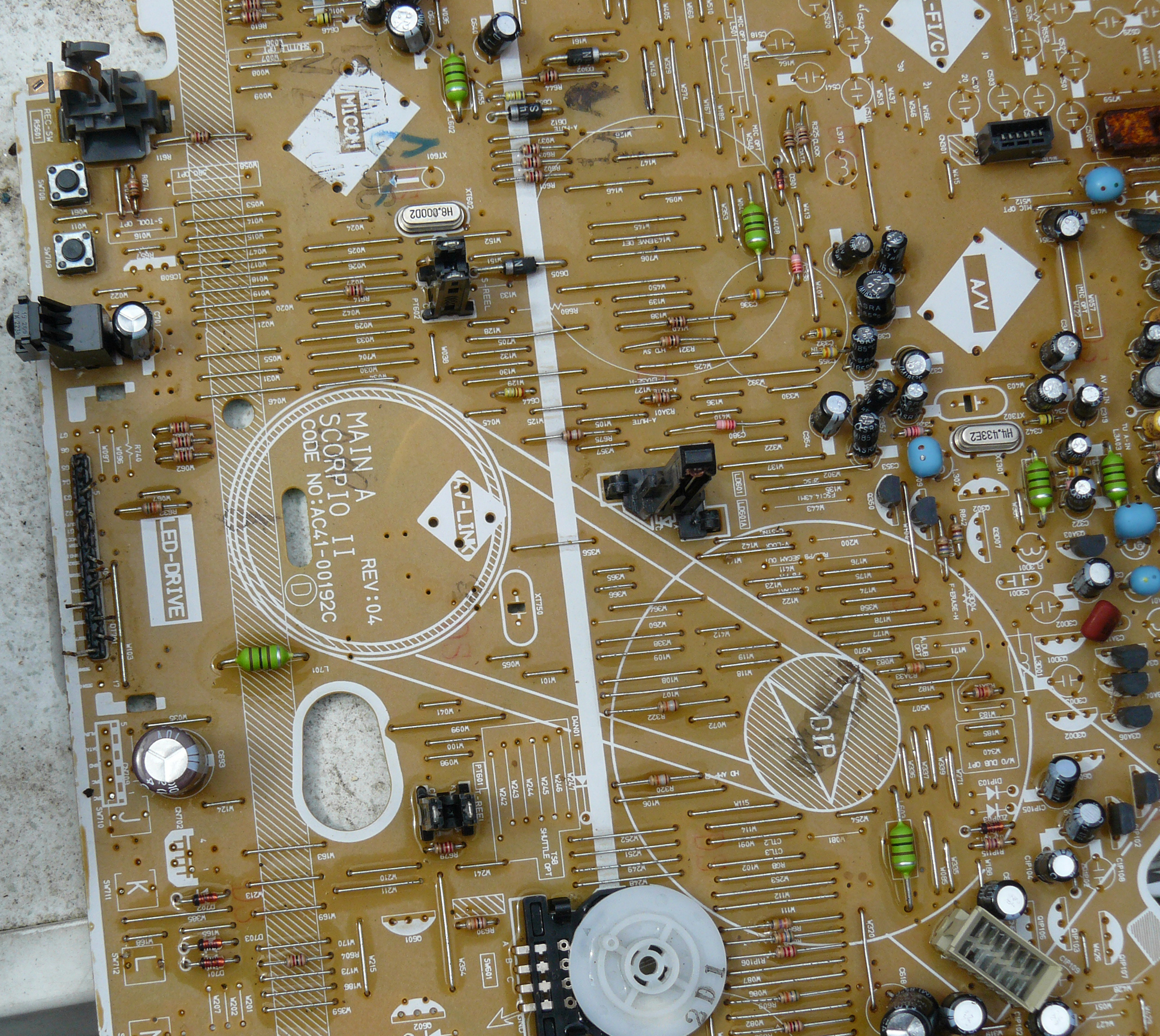

Thanks for the tip; as it happens, I did recently disassemble an old VCR. However I had another look at the board and there only appear to be a two ICs on the whole board, one appears to be a timing IC (L51DC), and the other is a very small 4-pin IC towards the back of the board which seems unlikely to be related to the infra-red functions. I haven't been able to identify the infra red components; perhaps that's just my inexperience with electronics though. I've attached photographs of the board; if someone could point out the components related to the infra-red I would be grateful. Please ignore the backdrop
In the meantime though, it seems unlikely that I'll be able to use any of the components in the device I would like to build, especially as the board has been left out in the rain for a few weeks as I thought I would have no further use for it...

Alright alright, obvious to someone who knows what they're looking for :( thanks for the info. I'll go take a closer look at that now.
Edit: Okay I just had a homer simpson D'OH moment when I turned the board slightly and noticed that I could see the photodiode component from the new angle. It doesn't appear to be controlled by an IC though, and it seems to have several different components, so it doesn't look like I'll be able to salvage this. I think I may have an old TV somewhere, I'll see if I can salvage the required component from that.

It's not 'controlled' by an IC, it IS an IC, mounted off the board in that plastic fitting, with the three pins running down to the board.
Incidently, that's a Samsung VCR PCB - althoough it's used by many other 'manufacturers' as well, including Sony and Toshiba.
Bit more info - the IR receiver has TK2238 on the top of it, immediately to the left of C701.

The tube can stay charged up for a while, as can the main electrolytic, those are the only sources of shock hazard, but neither are really dangerous as such.
Depending upon what you intend to salvage for your stock, there are still a couple of things left on that board which may come in handy.
PT601 & PT602 opto-interrupters may be useful if you plan on any motion control/feedback projects and the inductors L602 L603 L701 et al may also come in handy. Be careful removing the inductors though, they don't stand up to rough handling.

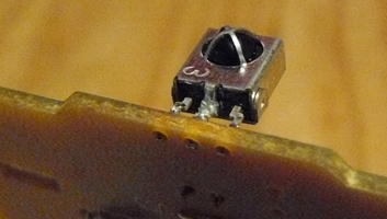

By the way, now that I know what an IR IC is meant to look like, I think I probably could have saved some time. I believe this is also an IR IC, correct? (See photo)
Yes, that's correct - if you're taking it out of something, it's a good idea to check the connections while it's still in circuit, they aren't always the same.
