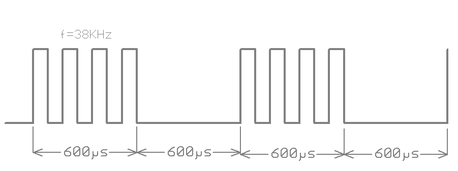

you should use two astables, one to create the "carrier" wave of e.g. 38KHz and transmit bursts of the 38KHz signal of 600µs duration with a break of 600µs.
The transmitted pulse pattern should look like this:
Boncuk

Nope. IR pulses won't be longer, but interrupted remaining at the frequency your receiver is tuned for.
Receiver chips like the TSOP series (Vishay) reduce sensitivity by AGC if they receive a constant signal.
Check out any TSOP (most common are TSOP248X and TSOP 17XX series) datasheet. Recommended pulse pattern is the same for all kinds of receivers.
Using a dual timer IC (NE556) you might create the control signal by the first half of the chip resetting the second half every 600µs (meaning no transmission for that time) resulting in pulse bursts of the desired duration.
The effect is similar to pushing a bell button at intervals.
The receiver side won't have to be changed. Just hook up the receiver like you would do using a continuous signal.
