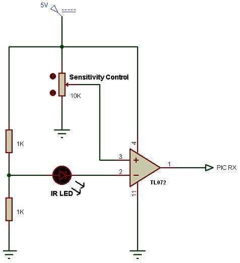

Thanks for you're help with the transmitter, now its time for the Receiver :eek:
The application is to record the speed (time between signals) from a reflective device on a rotating disc. The Transmitter and Receiver will face the disc with some cardboard directly isolating the two.
The pot offers sensitivity control of the receiver circuit for use in other applications.
I should also point out that I'm using the same IR LED emitter, and working off its low impedance with the same light spectrum present
A photodiode, phototransistor or light-dependent-resistor detects IR. Maybe an LED like you have detects a little but I have never tried it.
You don't show the polarity of your LED.
The inverting input of the opamp is floating so its output voltage is anything.
The minimum supply voltage of a TL072 is 7V so it probably does not work with only 5V. Its output low voltage might be +1.2V and its output high voltage might be +3.8V with such a low supply voltage.
The anode/cathode are hard to make out, but they are there non the less
The two resistors before the IR LED provide a voltage divider, giving 2.5V at the anode of the LED. This is enough to turn on the LED (only just driven on due to the high input impedance of the op-amp)
This leaves around 1 to 1.5V at the cathode of the IR LED (input to the -ve of the opamp)
As IR Light saturates the IR LED, it will 'turn on' more (the voltage drop will increase over it) reducing the voltage to the input of the op-amp.
At a threshold defined by the sensitivity pot, the op-amp's output will go high when the IR LED detects IR Light.

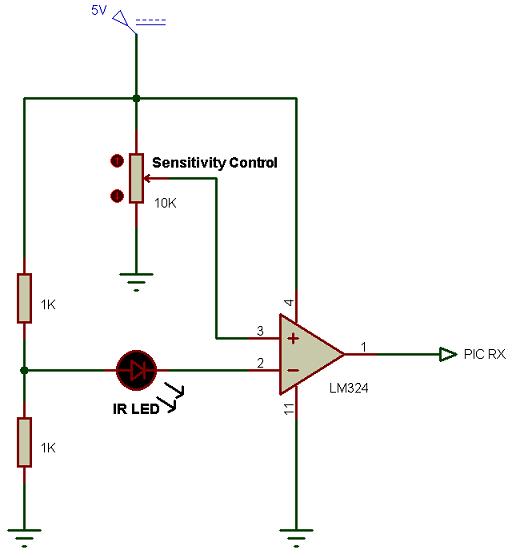

Thanks, I was using the LM324, and did a quick change to the TL072 as I posted (with the thought in mind that someone was going to pay me out for using such an old op-amp :eek:
I dont want to go outside 5V for the mean time, so I'll revert back to the LM324
Why not draw things that can be easily seen?? Nearly black on black? Try black on white.
The LED won't turn on since the TL072 has FET inputs so it doesn't have an input current, and the LM324 has PNP inputs that source (not sink) current so the LED will be reverse biased.
The inverting input of the opamp floats. If it is an LM324 then it will float up to near the positive supply and cause the output to go to ground.
The LEDs that I have tried perform like a solar cell and produce a small voltage. I don't know if your LED is sensitive enough to be used as an IR light detector.
