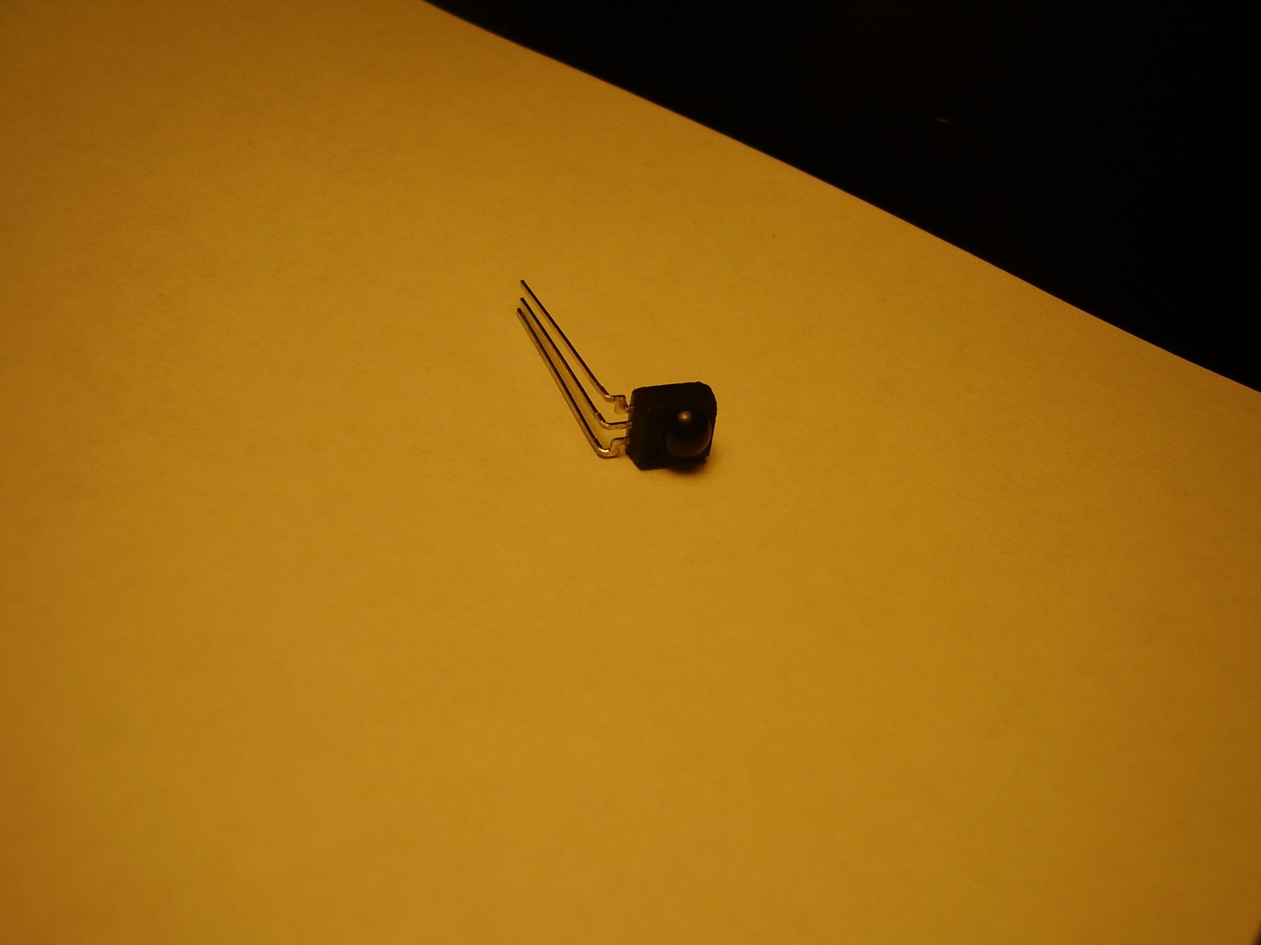

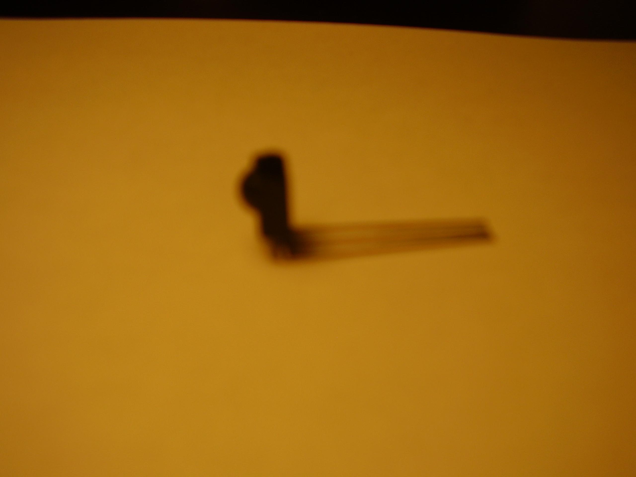

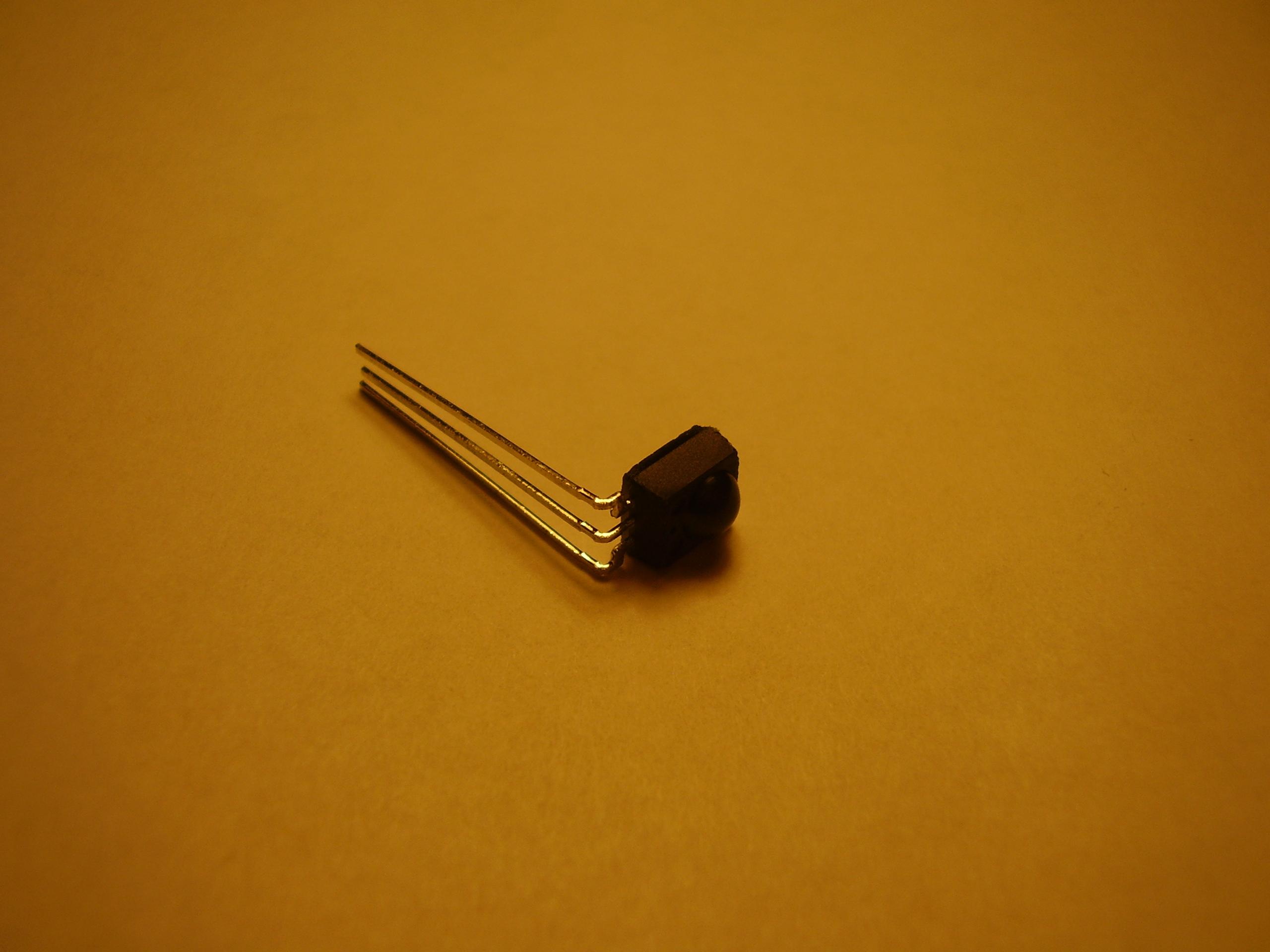

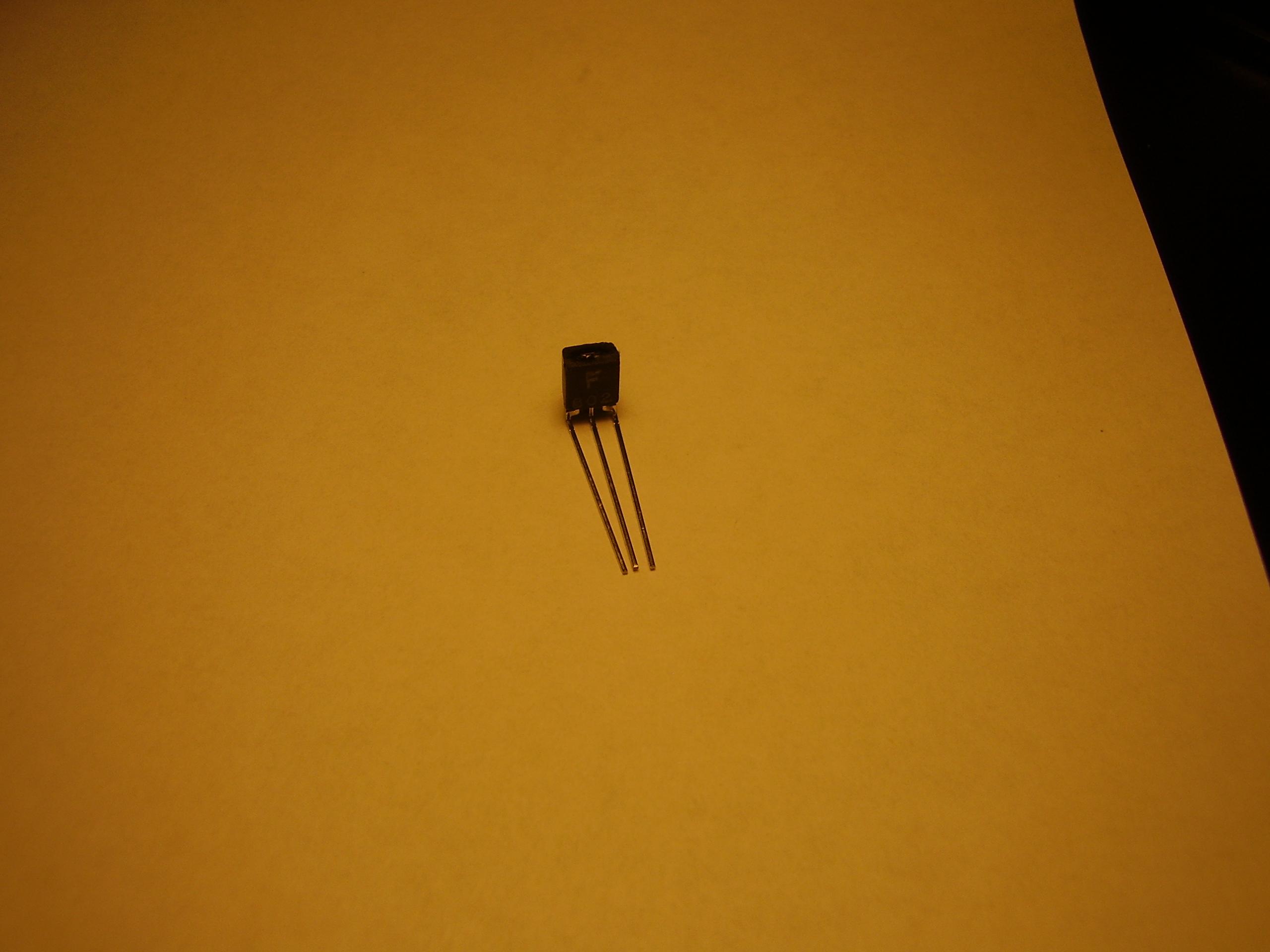

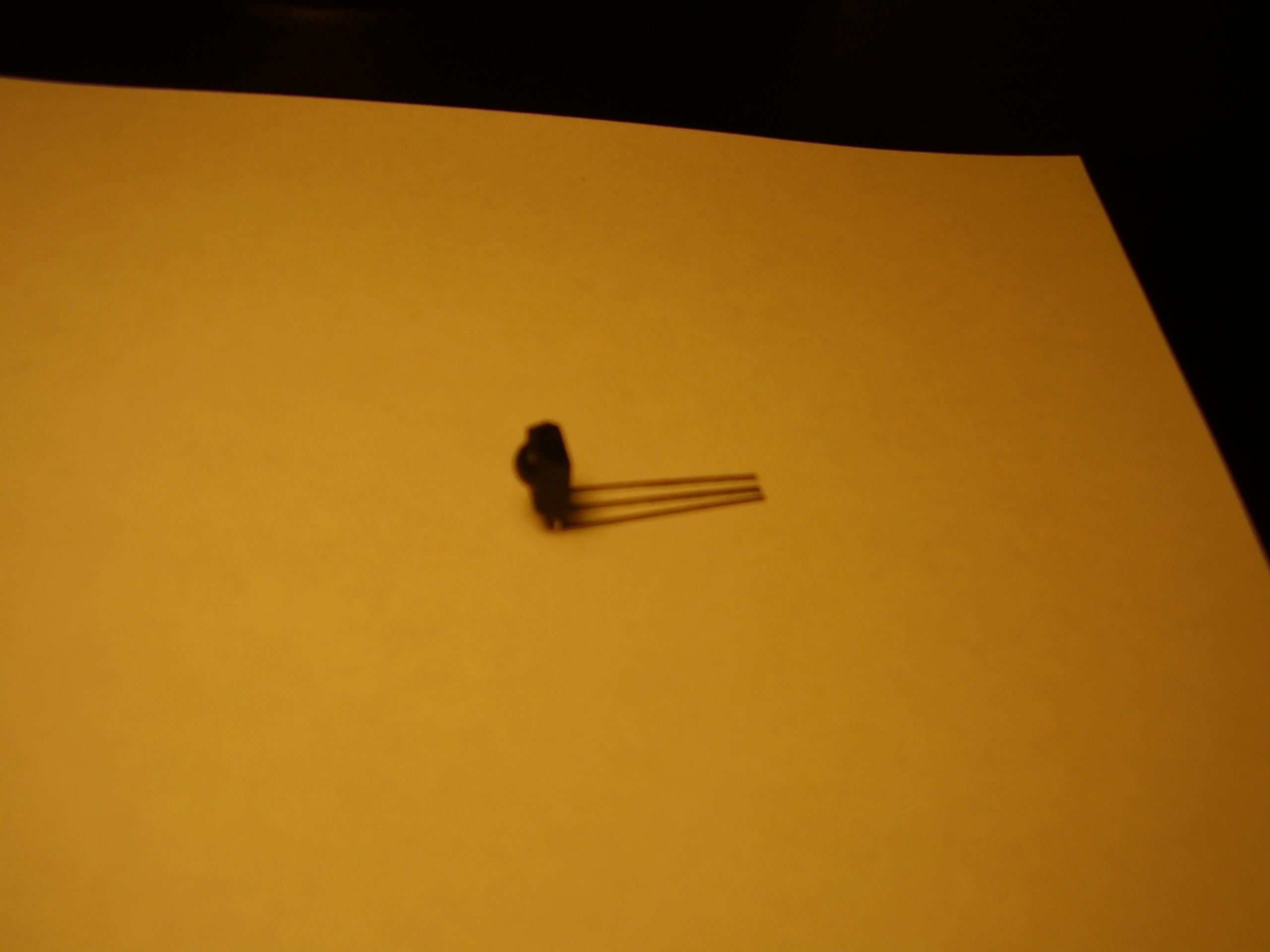

Hey,
I finally went out and bought the IR reciever module again.. i still do not know the correct way to wire it becuase I dont have the pinout or datasheet.
The pictures are attached below, I took shots of many angles.
From looking at the module head on (with the black bulb facing you)
what should the pin out be left to right?
Is there ANY way to tell if the pinout is correct?
Will the data line be 0v or 5v when it is wired correctly with no IR being emitted on it?
Thanks for any help!
Peter Wadley
Ps. I already know some of the pictures are blurry no need to tell me.

The problem with these IR receivers is that unless you know the part number you will not know which remote control carrier frequency it is designed to work with.
For example, the Vishay TSOP48xx series datasheet shows seven variants:
http://pdf1.alldatasheet.com/datasheet-pdf/view/26654/VISAY/TSOP4830.html
If you are lucky, it may be a 36kHz type which works with Phillips remote controls. (They use the RC5 standard protocol which can be decoded with a PIC micro.
see: http://users.pandora.be/davshomepage/rc5.htm
Throw it away and buy a real IR receiver from a real electronic parts distributor. Get its datasheet first.
How expensive is your part? I did an AVR project last december with an unknown and it worked fine. Go to Nigel's website and wire it up just like he shows. Don't cut corners, you need the cap and resistor. The output should be HIGH with know signal, drops LOW when it detects. The center frequency is a guideline for best performance, anything close will work to some degree. I used the remote from VCR and oscilloscope to verify it was working. Didn't know the frequency of the module or VCR remote, and all was well.

If, when you look straight on to it (bulb facing you), the right pin is 1 middle is 2 and left is 3..
I hooked 1 to 5v.. 2 to GND and 3 to a 1000:eek:hm: resistor to an LED going to GND..
The LED stays on until I point my TV controller at it.. which makes it blink off and on..

Sounds like it's working perfectly?.
Although I wouldn't suggest connecting the LED to ground, but from +ve to the output, so it blinks ON as it receives the pulses.
The source doesnt sell IR reciever, I cant find this damn IC anywhere except sayal!!!
Simply get one out of any old TV, VCR, stereo etc. - make sure you check which pin is which before you remove it.
