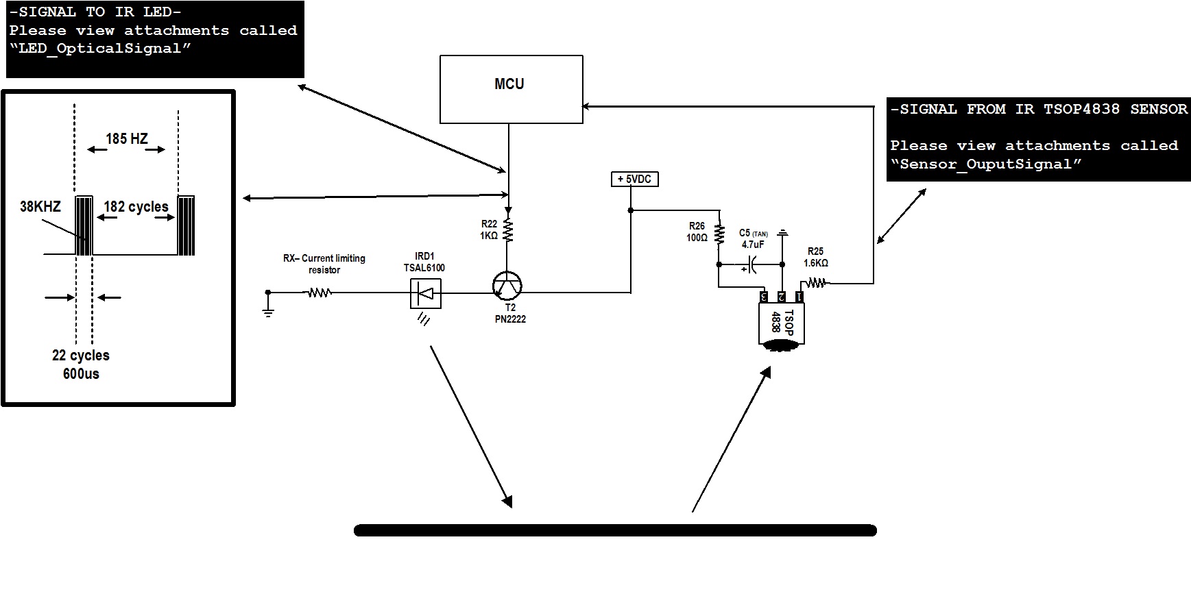

Hi guys,
Thanks for your replies.
For my IR LED, I am providing it a 38KHZ burst for approximately 600 us (aprox. 22 cycles). Then I am allowing a gap time of approximately 4.8 ms (aprox. 182 cycles).
According to the datasheet I *think* I am within specs (not sure though)…. You can view the signal the IR is generating in "LED_OpticalSignal.jpg" attachment.
Please view the “Schematic.jpg” attachment for more details.
In the "Schematic.jpg" attachment, I simply vary the Rx resistor to obtain the power desired for the infra red led. Doing so, permits me to see different distances. For example, if I require to detect an object at 3 feet, well there is a particular setting of Rx that will detect an object at 3 feet or closer. All the sensor does is output a continuous square wave when the object is within 3 feet of the sensor as shown in the “SensorOuputSignal.jpg” attachment.

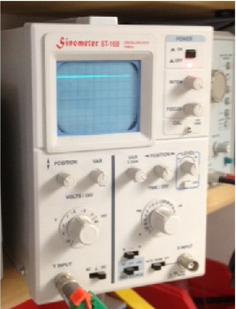

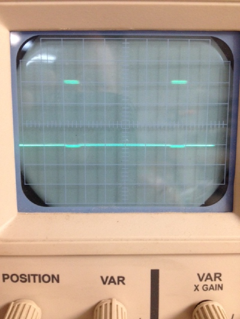

When the lighting in the room is approximately 0-800 LUX, the TSOP sees the wall which is at aprox. 36” and its signal is normal as shown in the “SensorOuputSignal.jpg” attachment.
However, when I direct a flash light right at the TSOP4838 part the TSOP produces no signal as can be seen in the “NoSignalFromTSOP.jpg” attachment.

How much current are you driving the IR emitter with? Your driver circuit is an emitter follower, so cannot put the full 5V across the IR emitter and its current-limiting resistor. Use a common emitter driver where the IR Led and its resistor is between the collector and the +5V supply. Also, get the IR emitter current to ~35mA (check its data sheet). You are pulsing it, so operating it near its max rating is ok.
You do not need the series resistor between the TSOP output and the MCU port pin.

Yep. The drive current needs to be several mA, minimum. I was trying to make a beam-break detector with a range of several tens of feet in bright sunlight, and I ended up putting about 50mA peak through the IR emitter.

I have to apologize.... I measured the IR Led current while the 38Khz burst was running. Holding the PN2222 in forward biasing mode (Fully saturated), I measure 25ma! This allows the sensor to detect 10 feet.
Unfortunately, when I flash the flashlight right on the sensor it blanks out and I receive no more signal???
Man!!, am I discouraged!!
I think even though I move the Rx and the IR led to the collector side I will still get the same problem.
I was wondering, are you sure its not the IR led that is not the best match for this sensor... maybe I should try a TSAL6200 instead... what do you think?
Also, are you sure its not the fact that my 38KHz burst is a little higher which may cause the problem???

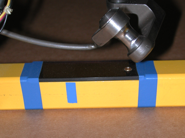

As I mentioned earlier, I have used a TSOP receiver in direct sunlight to detect an object by reflected light. It also works indoors. The IRED is shown. The steel tubing is 1" square. The receiver is behind the plastic.
Here's a picture:
I run the emitter at 5 mA or so directly from a pin of a 12F509. I don't recall whether you are using reflected light or beam break. To do reflected light at several feet might be tough. But for beam break, it should be possible. Have you tried putting the detector at the bottom of a short (2 cm), IR-opaque tube about 4 to 6 mm in diameter?
