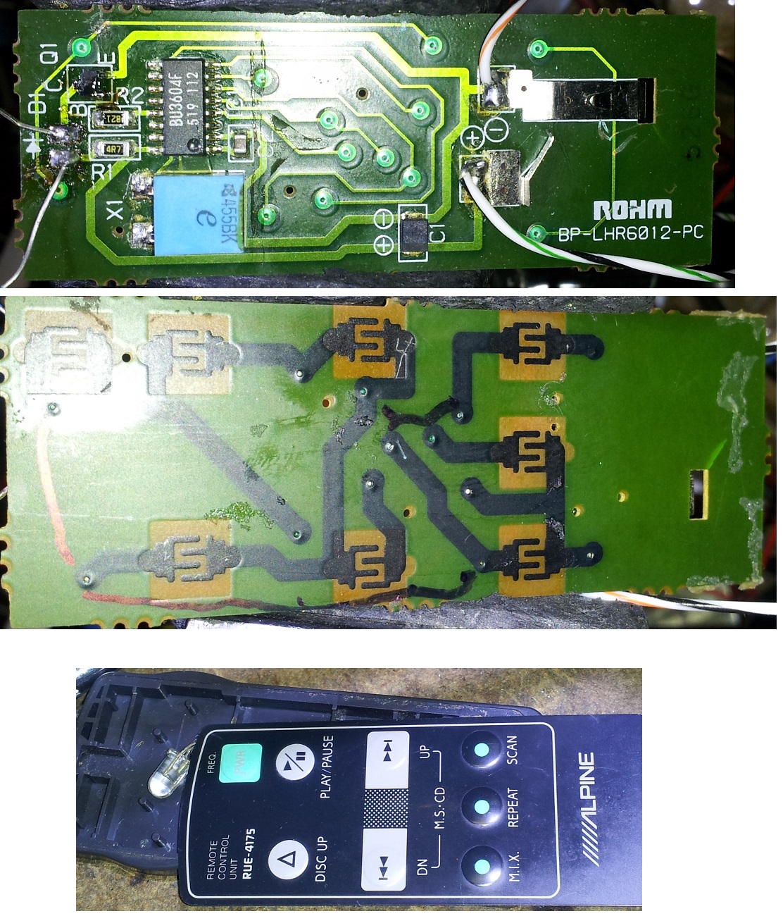

I have an Alpine CHM-S601 CD changer and the remote doesn't seem to want to work any more, I can get it function occasionally, but not consistently and Alpine is supposed to be sending me the specs on the output and I hope to be able to build a device using 555 timers to operate the CD changer. If any one has a RUE-4175 remote they want to get rid of, that would be sweet.
Also, on several devices that I have disassembled/torn apart, I found the receiver to be a dark 3 pinned device and I think it is a receiver/transmitter, do modern remotes receive as well as transmit? Does anyone know what a BU3406F chip is?

The 3 pin IC is a receiver only, and a complete IR receiver and demodulator - it outputs a representation of the original digital pulses.
The BU3406F is obviously the remote control transmitter chip.

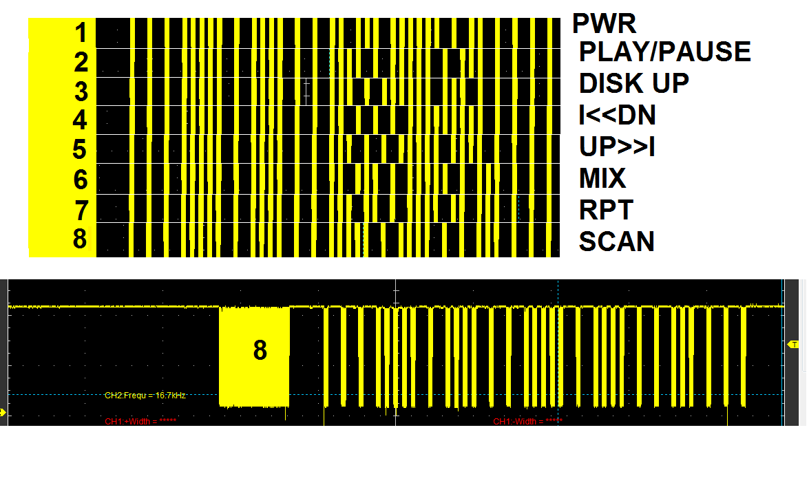

Turns out the remote control is OK, where the problem is, is in the semiconductive dots on the switch domes the make the contact when you push the bump down. While I was testing it, I make a scope shot of each function and then made on .png from all of them, definitely not something I could do with a mountain of 555s. Is the any way to make the dots more more conductive? I thinking I'll cut some dots of aluminum from some aluminum duct tape and stick over the black dots.

Over time, the dots and the base contact material gets covered in crud from greasy fingers and the odd drop of cocacola.
Take the thing apart and clean the PCB by washing with methylated spirit. Use a cotton swab and get the crud off the pcb.
With the silicon rubber bit, clean this down with metho on a cotton bud. Clean each dot.
Check the resistance across the face of the dot. This should be less that about 10 to 20 K ohm. If higher, then a bit of repair might be needed. Just check first though. To repair the dots, I use some graphite lubricant. There is a material use for lubricating piano actions and it is graphite mixed with a solution of ethanol and other stuff.
Its important with these remote controls not to flog them too hard when they become hard to use; pressing hard seems to transfer more of the carbon material to the PCB.
I've cleaned many of these things, and some earlier ones were hard to get working so you may have to persevere with applying the conductive repair gunk. Ultimately you will succeed. I've thought to try an aluminium piece as you say, but the graphite is the way to go.
Thanks for the advice Rumpfy, I took the push pad from my fluke and it worked well on the remote and the resistance of the dots was in the 2 Meg ohms region and that was with EZ hook probes, not pointy probes, so I guess I need to go find some graphite.
