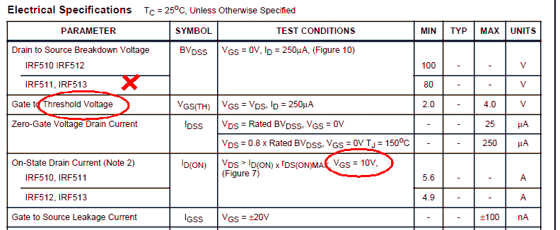

From a pin, I am alternating high then low to the gate of an IRF510, and the Pic(axe) ground to the Source.
Between the Drive and the Source I applied 12vdc.
There is no resistor between the Pic(axe) pin and the IRF510.
The circuit works... for small loads. I can flash a 12v marker light that has a small bulb, but when I hook up something like a brake light, the filament is really dim.

The ~5 volts from the pic isn't fully turning on the irf510.You need a logic level mosfet or a mosfet driver.

Do not look at the value of threshold voltage.
Look for Vgs=?? for lowest RDS or device rated current and that would give you an idea of what voltage you should apply to the gate to get that current.
An IRF3711Z logic-level N-channel Mosfet (and hundreds of others) is spec'd to have a max on-resistance of 0.0073 ohms when its gate is only 4.5V and its current is 12A. Then its max dissipation is only 1W. With a heatsink it can conduct much more current.
A low value resistor (22 ohms) should be connected in series with the gate pin mounted at the pin to stop the Mosfet from oscillating at a very high frequency.

THEY CAME IN THE MAIL TODAY!
SMT was no problem, laid it out in Pad2Pad, board etched nicely, MOSFET works 100% PERFECT! LL +5 direct from Pic(axe) to MOSFET, switches a turn signal bulb at 12v without a hitch!
