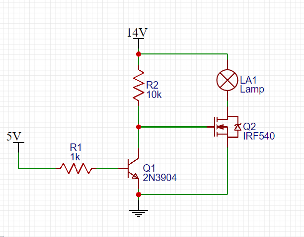

I would like to ask for some help in my circuit. What could be the possible reasons why my IRF540 doesn't turn off?
I check the gate voltage of mosfet when I toggle the gate of 2n3904. when I put 5v on the base of BJT the gate voltage of mosfet is 0V and when I switch it to ground the voltage is almost 14V.
Here is my schematic.
Thank you!

Are you sure you have your FET connected correctly? If drain and source were reversed, the body diode inherent in the FET would keep the lamp on.

That is exactly the behavior I would expect.
I) When 0V is applied to the base of 2N3904, there is no current flowing through the 10k ohm resistor so 14v are measured on both ends of that resistor. This means 14 v is applied to the GATE if the MOSFET and the mosfet allows current to flow through your lamp.
II) when 5v is alllied to the BASE of the 2N3904, current flows from collector to emitter and (which must flow through the 10k resistor as well). That means, if you put your volt meter across the emitter and collector of the 2N3904, you'll measure only 0.2v and measuring across the 10k resistor, you'll see about 13.8 volts. That means the V(gs) of the MOSFET is only 0.2 volts so no current will flow through the mosfet - your load will be off.
Hi alec_t,
Thank you for your response. As i read your comment. I immediately check the mosfet and I found out that the drain and source is shorted. when i tried to replace it with 045n10n a N-channel mosfet. It successfully turn off the lamp. I didnt replace it by Irf540 because i dont have any spare. Thank you!

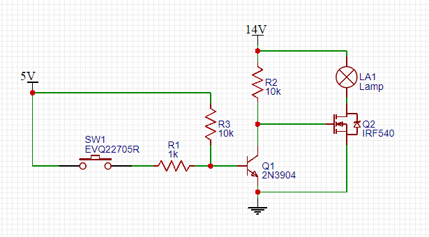

Btw. Should i pull up a 10k resistor in base of 2n3904 to set the mosfet off in initial state?Is that the correct way? Cause I toggle the 2n3904 using a microcontroller and i found out that the mosfet is on for a few seconds and then turn off when the microcrontroller is done with initializing.
Yes, that is one method, a pull up on the base will keep the NPN on and the MOSFET off when the microcontroller is powering up.

Is the 10k pullup and 1k resistor to base is enough?

You'll need more resistance or you'll never get the NPN to shut off (depending the sequence of your connection. Post your schematic so I can make fun of it (I mean, check it). The mosfet Gate does not draw any current.

Hi!
Is the resistor value enough to fully turn off and on the 2n3904?
The values are ok but the connections are wrong.
Actually, in the image in this post, the 10k could be changed to a 100k and 1k changed to 10k.
Connect your resistors like this.
How about this setup.. does this make the mosfet initially turn off when mcu is powering up?
The mcu pin here controls the ground.

No, that will not work. Put a 10k to 5V so the transistor is held on and a 1k to your pin so the Gnd (pin low) can turn the MOSFET on (transistor off).
