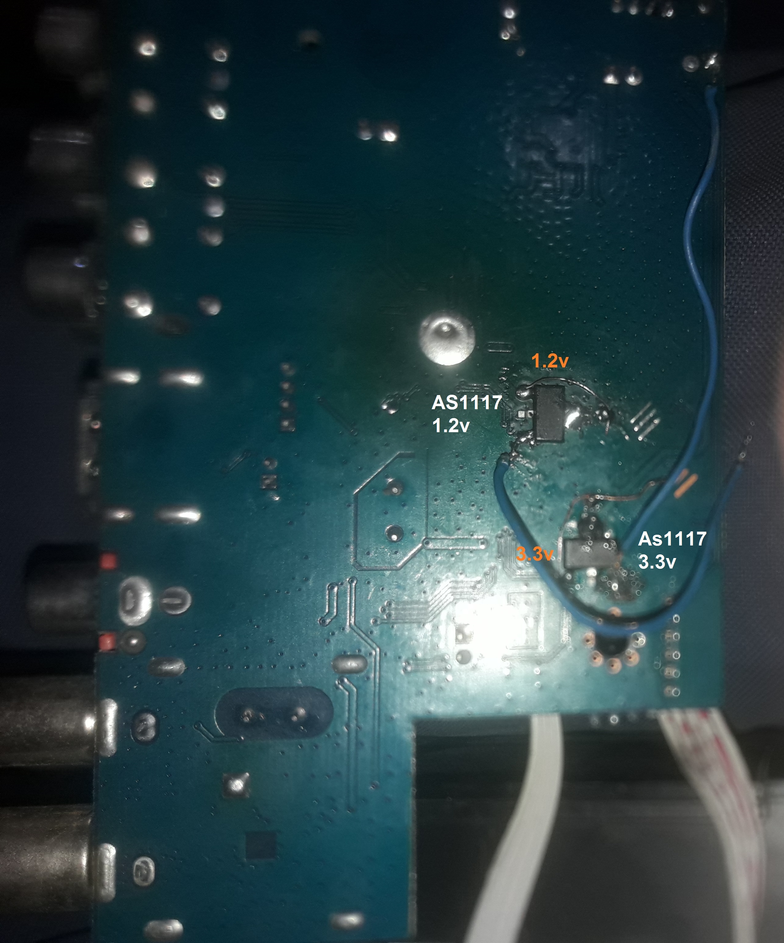

As an electronic repair, they bring me set-top boxes, receivers, modems, TVs, etc. for repair. Interestingly, there is a common point between all these devices that the IC regulator of the 5v and 3.3v 2.5v 1.8v 1.2v power supply section burns. Is it possible to use the 1117 constant voltage regulator for the ease of work and the lack of time and energy spent to check the datasheet of the 6-pin or 5-pin IC?

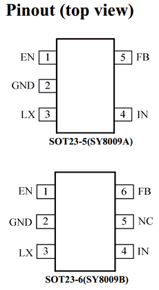

The SY8009 is a switch mode voltage converter whereas the AMS1117 is a linear regulator. Not the same thing.
https://www.olimex.com/Products/Breadboarding/BB-PWR-8009/resources/SY8009.pdf

The pinouts also look different to me.
I know the output pins, I wanted to replace the board with three pins from the main input and output pins or the IC auxiliary board. If this trick is implemented, my work will be easier because some ICs are not available in our country and market

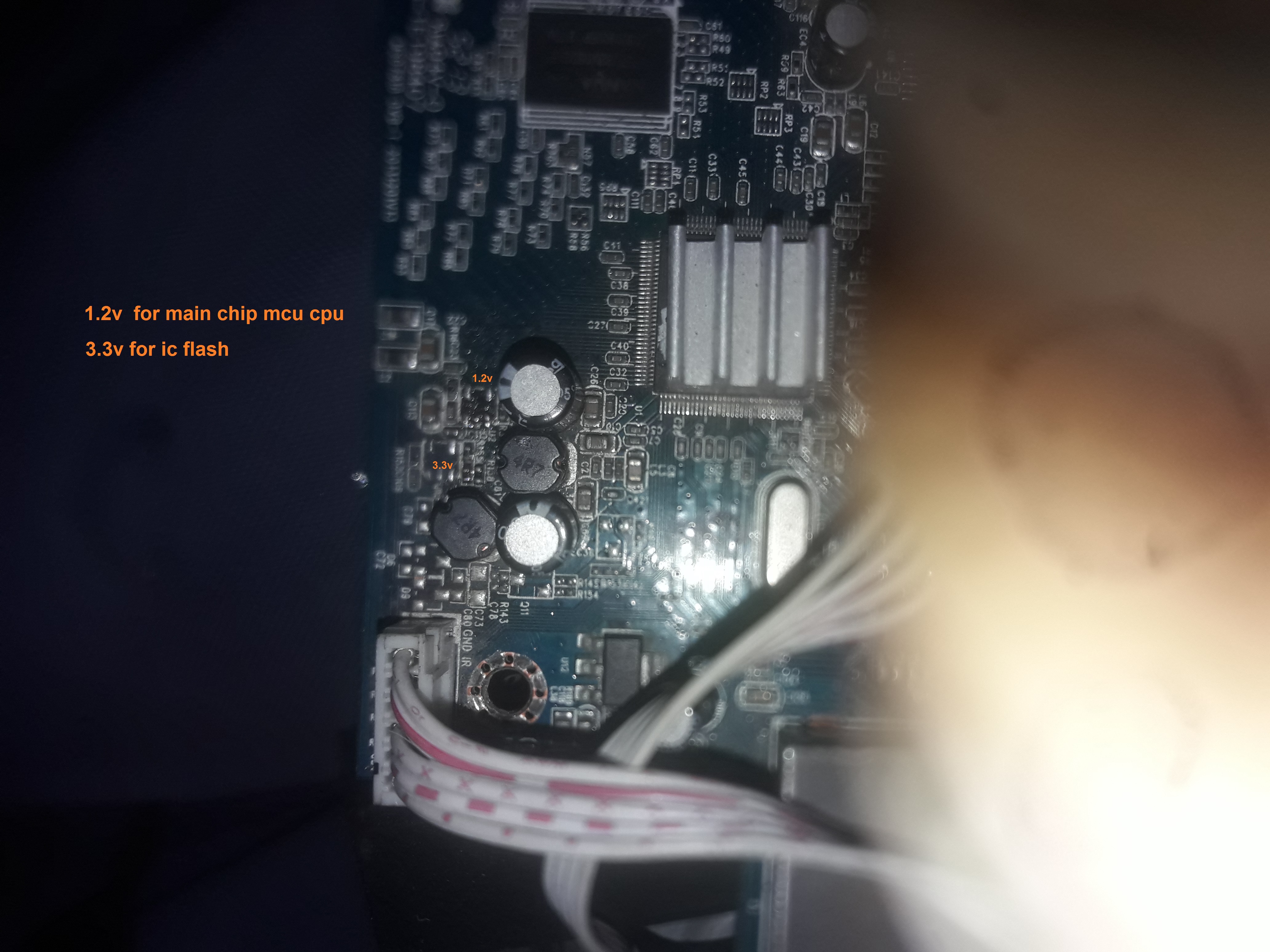

There is a digital receiver board (setup box), the IC regulator part of the main board is 3.3v and 1.2v burnt, the 5-pin IC regulator is not available, so I have to consider a constant voltage regulator for it and take the work to the customer.
As has already been pointed out, the original board was designed with a switching regulator. They must have made that choice for a reason. You would be risking a great deal by replacing the switching regulator function with a linear regulator. Are you sure it will survive in the enclosure over a range of ambient temperatures. If I was your supervisor and you brought this idea to me, I would reject it out of hand as unworkable. If you customer would be unhappy then tough rocks.
