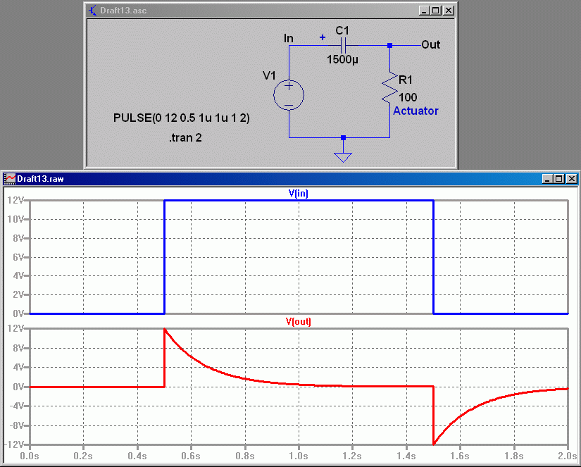

It is a car door actuator that I am trying to control here. Takes a .2 second 12 vdc pulse one way to actuate it one way then a reversed pulse to have it go the other way.
A capacitor? What is the resistance of the actuator?
According to my cheap multi-meter, between 2 and 3 ohms
That would take a huge capacitor. RC = 0.2, R=3 therefore C=0.07F or 70,000uF.
It is simple, if you have room for a 70,000uF 3lb electrolytic capacitor :D
Space isn't a huge issue for this situation but I don't think I want to spend too much money for just a capacitor.

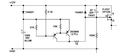

I realize the negative pulse when power is removed might not be possible
It's easy. Create an "internal rail" fed through a diode from your positive power rail to a electrolytic cap. As power goes down, the primary rail drops. Use a comparator to detect when the primary rail is below the "internal" rail across the cap which powers the comparator. Use the comparator to fire a 555 one-shot and make a pulse as the prime rail is going down.
Here's an example. The PNP's bases are turned on by the 5.1k resistor as the 12V rail falls and the cap's voltage holds up for a while.

So...
I could create a circuit that has a 555 timer hooked up as a regular one shot timer that would give a positive pulse. And also have an internal rail as you describe that would fire a second one shot 555 timer wired to produce a negative pulse? Then I just need to work out how to make sure I'm not causing anything funky to back feed into the wrong parts of the circuit.
Cool Time to look up some stuff and see if I have the parts on hand to do anything with what I find.:)
If you want to generate a pulse in either direction for the solenoid, then you will need to drive it with some sort of bridge circuit. But you will need some source of power for the negative pulse when the rest of the power is removed.
