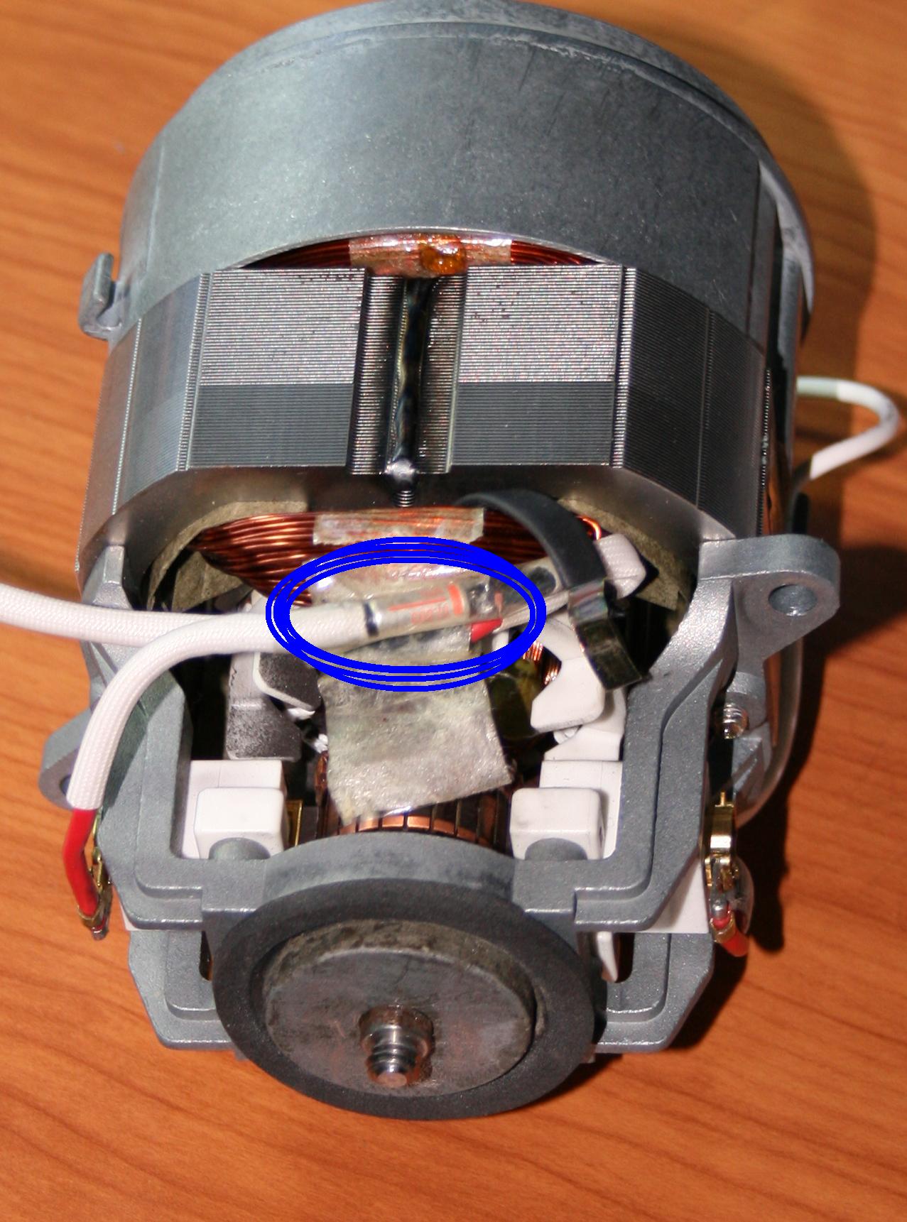

I have this motor to a kitchenaid blender that needs fixing and I am trying to get daily intake of smoothies again. A man needs his fiber! :eek:
So with that said. :)
This motor has a blow "something-or-other".
The circled item in blue does not give anything with a continuity check across it.
Is it a fuse and if so which kind? Is it a slow burn fuse or a thermal fuse.
Here is the listed information written on the outside of it:
SEFUSE
SF139E
142 C (with the degree mark before the C)
10A
Any ideas? I know you all do... :p

Yes it is a thermal fuse, designed to 'blow' open at 142 C and rated to carry a maximum of 10 amps. These type do not 'reset' and once blown open have to be replaced with a new one. These are usually very reliable devices so you can assume that something bad happeded to cause the motor to get very hot...you drop your car keys in and hit max blend speed?

Well thank you for the information. I just happen to have a thermal fuse next to me at 144 C. Two C higher... I don't think anything will come of using that one. ;)

When you fit the replacement thermal cut out, ensure that it is 'thermal' contact with the motor winding as per the original position.
I would disagree, failure of the thermal fuse for no apparent reason is extremely common.

Well Nigel didn't state a statistical value to define 'extremely common' or any reference source that might state a reliablity statistic for this component type. Nor do I have anything more factual then my personal experience, so I figured the world is big enough to have more then one opinion about thermal fuses. :)
I had a Mr. Coffee blow one once when I turned it on brew before adding water......catch 22, I'm not fully awake sometimes unless I've had my morning coffee first ;)
Lefty
To quote a famous American, "lies, damn lies, and statistics" :D
My point of view is a personal professional one, as a service engineer for 36 years I've seen a LOT of failed thermal fuses of that type - and I've hardly ever found a cause for their failure. Possibly it's caused by misuse from the customer?, we've no way to know, but 90+% of the time simply changing the dead fuse gives a 100% cure.
