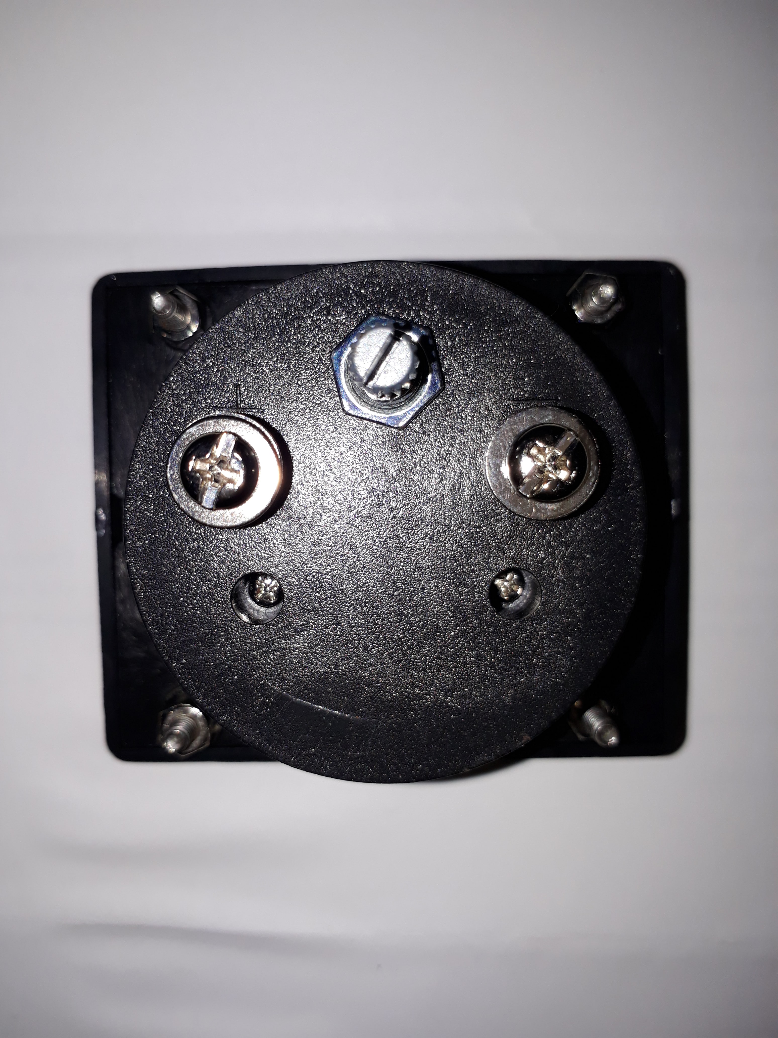

I attached a 1.5 volt AA battery to the said RPM meter and the needle moved a little as suggested by ronsimpson. I tried it with a 13.8 volt regulated dc power supply and the needle moved much bigger(probably 50 rpm). attached is the back view and the whats inside the meter. I also tried to get the reading on the terminals of the rpm meter. It read approximately 27 on X10K . I hope these data will help determine if I can connect these to M+ & M- .

Can you trace the circuit? It should be
[Terminal]--- [resistor]---[pot]---[meter coil]---[terminal]
The order may be changed, but everything will be in series. Replacing the resistor and pot with an appropriate resistor and you can make the full-scale voltage be anything you desire.

Are you not getting the pictures? (they appear to be hosted here), the second one clearly shows how it's wired internally, there's a 150K between one terminal and the meter, and a 100K pot between the other terminal and other meter connection.
I'm more bemused about the scaling of the meter, and wondering what rev counter uses a 160V output?

If 13.8v makes it move to 50rpm, then to get to 1800rpm you would need 496.8v but that sounds too high.
With the 270k resistance measurement, that would make it approximately 270v to get to 1800rpm.
With the internal picture, we see a 100k resistor i think and a 100k pot. If the pot was adjusted to around 60k then the meter would read 1800rpm with 160 volts.

To be fair it's pretty obvious, it's a 1mA meter, and the series resistance is so high as to totally swamp the internal resistance of the meter (so that can be ignored), so it should be 150V FSD with the pot at one end, and 250V FSD with the pot at the other, +/- the tolerance of the resistors.

Oh ok good, i thought that resistor was 100k but now i see that one band is green not black making it 150k which of course means the adjustment range is 150k to 250k or in terms of voltage 150v to 250v.
From his new readings i get 139v to 150v full scale without changing the pot setting, whatever that is at.
So i assume that the pot is to be adjusted to get 160v full scale, in whatever application that was intended for.
