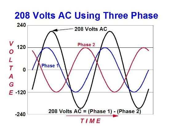

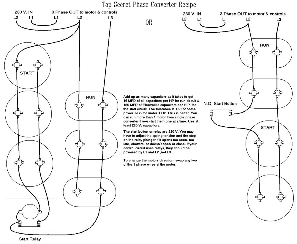

Is this circuit viable ?
Would a capacitor type phase converter out put be like the Wild leg 3 phase?

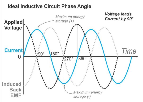

Thinking about inductors vs. capacitors and current lagging vs. leading, what would the current timing look like on those two when applied to a motor?
I found a few pictures but not voltage vs. current on 3 phase.

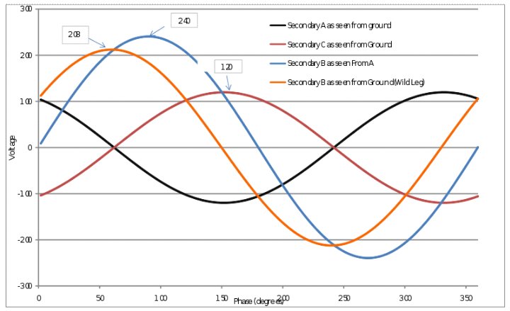

A minimal amount of caps would probably look like what I call a "wild leg", enough caps of the right size could "tune" it to look like true 3 phase. I actually think your first diagram answers your question concerning true 3 phase, and of course the voltage and current values would be higher for the wild leg. Yes they only show a single phase, (probably because the 3 together on the same graph would be too crowded to read), just copy the wave forms of that graph and paste it right back on itself two times at the next 1/3 of the time cycle each (in this graph that would coincide with the 120 and 240 degree locations on the time vector) and that is what it would look like. I don't understand the next two graphs, mostly because they are using voltage terms that I simply don't know/understand/am not familiar with.
Another thing that confuses me is realizing/remembering that when UK members refer to 230V single phase they are talking about a hot and neutral. When US members refer to 230V single phase they are talking two hots and maybe a neutral. It is interesting to me that they can make a 3 phase motor run on their voltage, what US members would relate to as 120V.

Would such thing work?

The only one I could measure easily is a 10 HP on my lathe. It was 248 to 250 volts across all legs. I can't see the actual cap markings because they are neatly bundled.
For a 2 HP motor they would be 30 uF oil caps for the run circuit and 300 uF electrolytic caps for the start circuit.
The tolerance is +/- 7.5 uF on the oil caps for the run circuit and +/- 75 uF on the electrolytic caps for the start circuit so get as close as you can with standard denomination caps.
