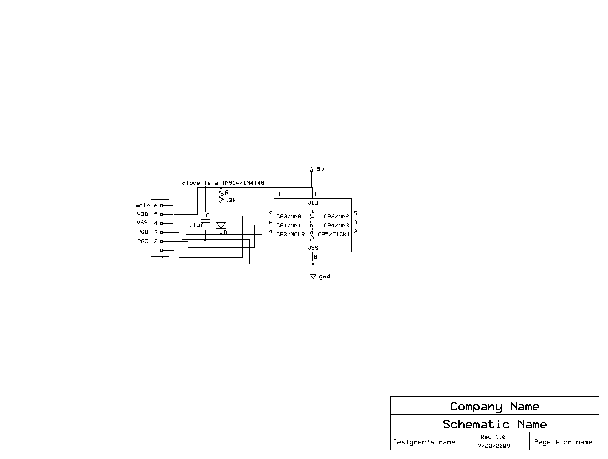

Hello all!
I am working on a project and need some advise. In my project the gpio3 is switched high for one mode and low for another mode. When icsp is used vpp or gpio3 is 12v right? So if gpio3 is in high mode How do I isolate vpp from my high signal circuit. (high signal switched from vdd). How do I isolate the low signal? (low switched from vss).
I am thinking that I need a resistor between vss and gpio3, but what value? and a diode between vdd and gpio3.
Thank you for any help
fiveten
ps: I am using a pic12f675 microcontroller
Here you some thing to go by It's how I do it
You are correct about the need for a diode and resistor, be80be showed you how. A 10K pull-down resistor to ground (switched of course) would be fine.
You don't use a pull down to ground from mclr chip will not run if you forget and set MCLR to ON in your config bits
Sure, but he says he is using it as a general purpose pin. Therefore surely he needs to switch it (not permanently wire) to GND or it will float?
I would pull it up like I showed him never pull mclr down then he can do what ever he wants GP3 is input only so if he used it with a switch it would read high and go low which is fine. But I wouldn't pull it low asking for trouble.

So If the circuit is switched in the vss mode I will not be able to program via icsp? I see in the diag. that only the vdd is wired to the vpp/mclr. My config has the mclr off. can I just have a 10k res. between the gpio3 and vss and be able to program via icsp?

Why would you want that pin low even if you used a switch on it and let it be high switch open and low switch close you'll be ok here read this and see for yourself

the programmer has to pull it up from +5 volts to over 8.5volts min some need even more like 11 or 12 volts
if it can't over come the resistance it will not program

If MCLR is pulled high with the normal resistor+diode combination and pulled low with a switch, it should program fine when the switch is off.
That what I said all long I don't see a good way to program in socket and have mclr being pulled low. You can program the chip and turn off mclr and then use it like he wants. But it is a bad idea to switch mclr low. That's how it resets the chip. Post your circuit. Are you wanting something like this **broken link removed** there not pulling mclr low it's pulled high and when you press the button it goes Low just like what I been telling you you could added what i posted to it and be all set for icsp.https://www.electro-tech-online.com/attachments/12f675-png.31597/

Fiveten you have to preprogram your chip to use it like the CG Sleeper you need p-dips like there using or put a jumper to unhook mclr till you get it programed
