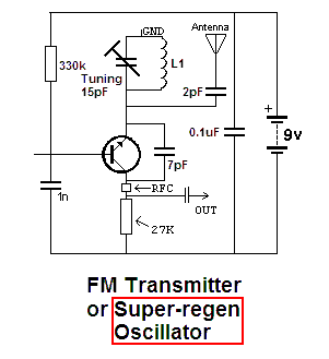

MStechca,
I don't know how your transistor can work with the collector's tank circuit connected to ground.
The pic that I posted in your other topic shows how easy it is to turn a simple FM transmitter circuit into a super-regen "receiver": just add a choke and capacitor in its emitter to make the RF oscillator squeg, where it begins an RF oscillation but a received signal is rectified at the transistor's emitter, charges the capacitor and cuts-off the transistor. When the capacitor discharges a little into the resistor then the oscillator starts again.

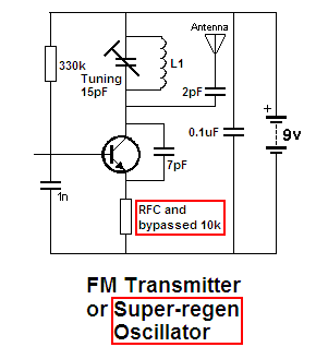

This is my version. I don't know how it works with you, but this mode cooperates a bit with me.
EDIT: The resistor is actually a pull-up resistor not a pull-down resistor, so ignore the diagram if you are examining the pull-up resistor.
Your transistor circuit doesn't do anything because it doesn't have a power supply. Both the collector and emitter are at 0VDC!
you must of replied before I edited my post. The 27K is supposed to be a pull-up resistor.
How can I ignore the diagram you posted. It shows the transistor without a power supply.
If you have the 27k resistor connected to the positive supply, then the transistor is saturated and still doesn't do anything.
I will redo the diagram and then post it later.
