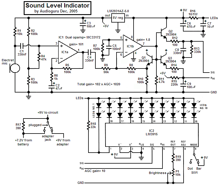

Those ASCII schematics are horrible.
I use Microsoft Paint program to copy and paste pieces of datasheets or other shematics.
Here is a example of my schematics made with Microsoft Paint program:
