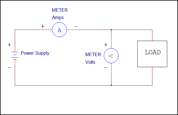

Well i've connected the Negative from the Power Supply directly to the Negative of the LED Panel, and the Positive from the Power Supply, i've connected it to one probe of the Multimeter, and the other probe i've connected to the Positive of the LED Panel.
I did it wrong?
I did it wrong?
When measuring voltage it is measured in parallel with the load. When measuring current is is measured in series with the load. You need to break a load line so the meter can be in series with the load. Similar to the attached where the current to the load passes through the meter.

Don't all NOOBs connect an ammeter wrong so they blow out its fuse?
I didn't blew up the fuse, because it's unfused and it can measure 20A max, i've measured correctly, it's really strange indeed, but i will try tomorrow with another multimeter to see if the same result shows up.
