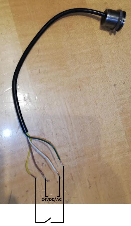

So, I've damaged 3 piezo buttons...
This is the piezo button: https://uk.rs-online.com/web/p/piezo-switches/1241087
Datasheet: https://docs.rs-online.com/9e69/0900766b8152fb83.pdf
Quick explanation on what MPZI019/F/BL/24 is:
MPZI - Illuminated piezo switch
019 - 19mm diamater
F - Flat head
BL - color of illumination, in this case it is blue
24V - illuminating LED voltage
Also, it is a momentary switch, not latching.

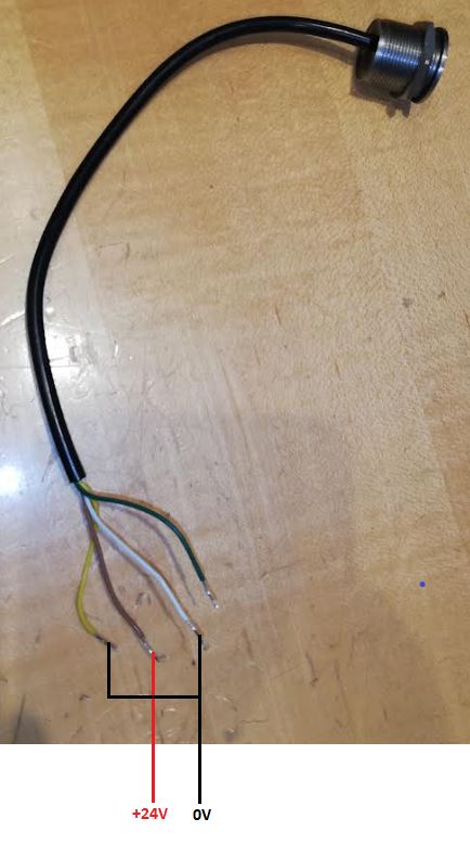

This is the pinout:
This is how I connected it:

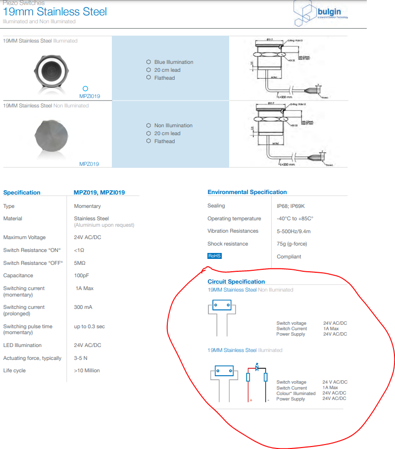

If you look at the datasheet, the switching contact is rated at 24VACDC 1 A.
It seems that I have destroyed 3 buttons.
There is a short between brown and yellow.
What did I do wrong???

That series of switches includes ones without LEDs; they do not require power to work (other than the "latching toggle" one).
The LED is a totally separate indicator lamp in the momentary type.
The switching device is triggered by voltage from a piezo transducer & also possibly powered by stored energy - they probably draw a few microamps when open circuit & charge a small capacitor to hold the switch on for a short time when pressed.
Once you have found the LED wires, ignore them for now.
Just use the other two. Connect to power with a simple load in series - eg. a 24V led & resistor combination.
Try both polarities in case it only works one way.
