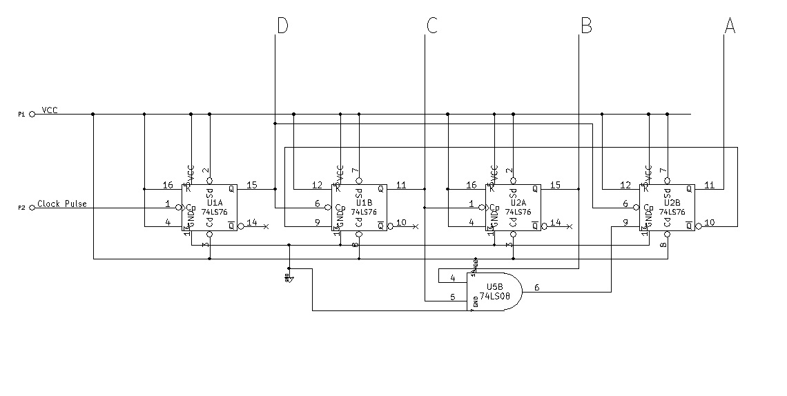

I have a bit knowledge on how j-k flip flop works and were currently discussing it on my school but I still dont get this one.
how does the counting goes back to zero"0" when it hits to "9"?
can some help me explain this one. ( :

Look where pins 4 and 5 are connected on the 7408 AND gate.

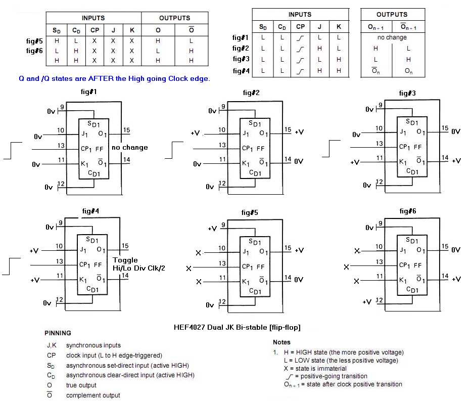

EDIT:
This diagram will help.
