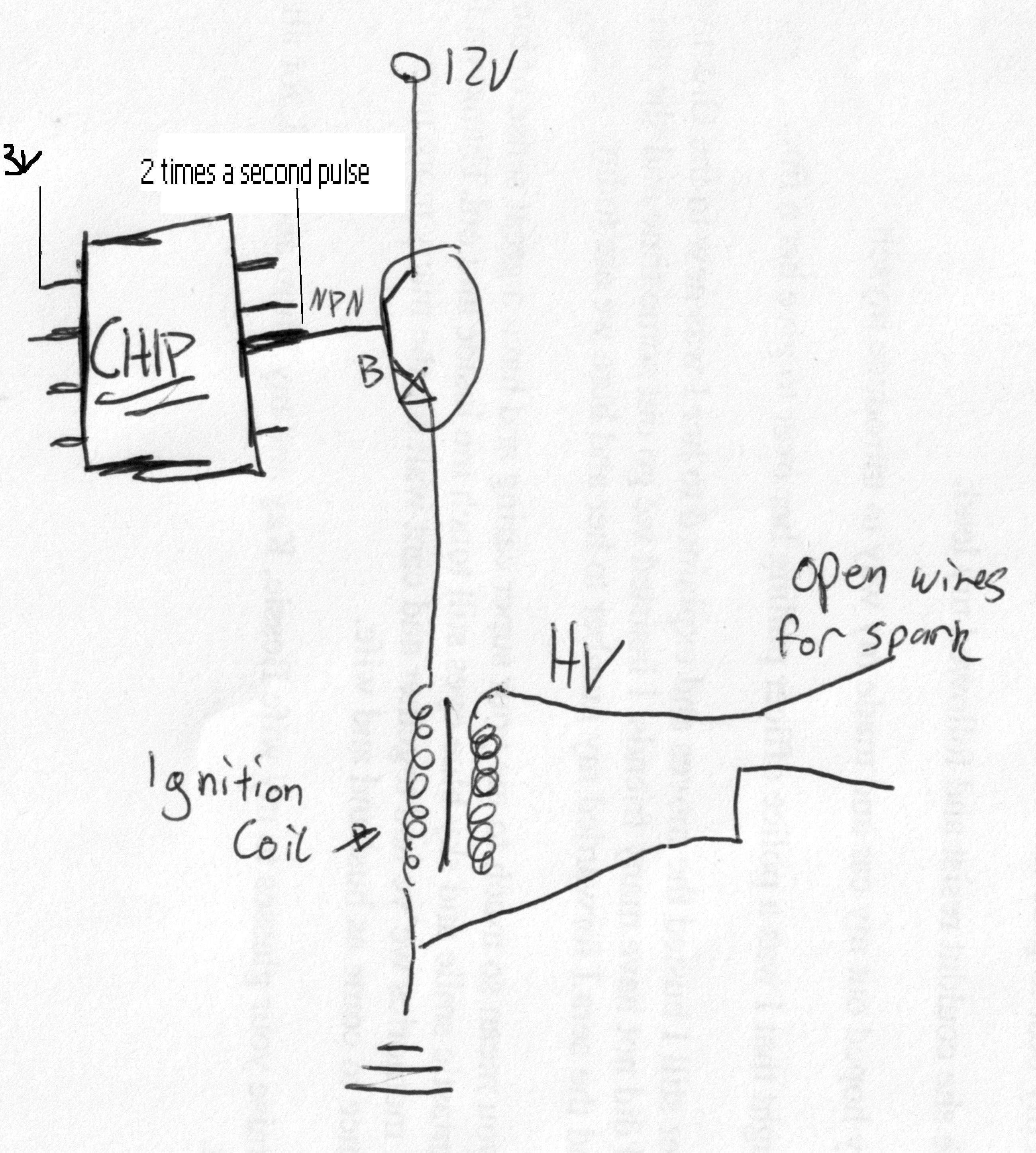

im thinking of programming a chip to create a pulse of dc
Circuit has a chip connected to the base leg of a transistor. E and C of the transistor has 12v going through it to the ignition coil. The chip will be programmed to send a pulse to the base of the transitor 2 times a second. What do you think? How can i stop back EMF? Will the transitor get dammaged?
Thanks. Below is the schematic.
To make a spark you need much more than 12V on the primary of the coil. You need the back EMF to have enough voltage to make a good spark. You control the back EMF with a small capacitor in parallel with the primary, but it has to get up to about 200 V so the transistor has to be able to stand that.
The circuit shows the transistor as an emitter follower. If you arrange it that way, the output voltage will only change as much as the input voltage so you won't get 200 V.
2 sparks per second is too few. A Jacob's ladder rises because the air heated by the sparks rises, but 2 sparks per second won't keep the air hot.

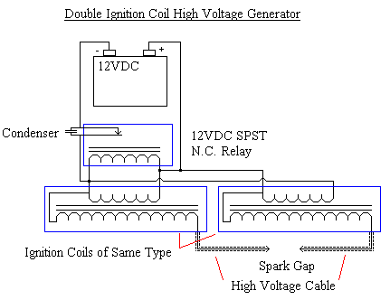

Here is some schematics i found on the web, but im kind of lost whats going on here and how its creating pulsed current?
Aswell that condenser is a non-polarised capacitor in other words right?

The relay is normally closed, so current flows, into both the ignition coil and the relay coil. Both are inductive, so the current takes time to build up in both. A few milliseconds is all that is needed.
When the current builds up in the relay coil, the contacts open. The current drops very quickly. The high rate of change of current gives a high voltage, which is transformed by the ignition coil to give a spark.
The condenser is a high voltage capacitor. It stops the voltage getting too big, and allows the arc at the contacts to stop. Old contact-breaker ignition systems needed one.
The system is very similar to the spark ignition system on an old car. The only difference is what opens the contacts.

Ive just quickly tested the attacheted schematic without succes.
Where is the earth on the ignition coil, theres only negative going in via common of the relay.
Aswell how is this making a pulse?
On my relay (which ive borrowed from another project) ive got attached a diode across the negative and positive so it cant short, should this be removed?

The ignition coil has two primary connections, one is connected to each side of the relay coil.
The diode will stop it working. Read my description of the 31st March. To get a spark, the current in the ignition coil has to stop very quickly. The diode lets the current continue.
If you want a physical analogy, imagine how you would produce a large force with a hammer. You are not strong enough to produce a big force on your own, so you use your strength to accelerate the hammer. When it is going fast, you swing the hammer into something solid. The big force comes when you stop the hammer, because there is a large deceleration of the hammer. If you swing the hammer and do not hit anything, there is no big force, because the hammer does not decelerate quickly.
In the coil, the current builds up slowly with the 6V supply, like you hammer gets faster over about 1/2 second as you accelerate it.
When the contacts open, the current has nowhere to go so stops quickly. There is a big voltage created. That is like when the hammer hits something and stops very quickly. A big force is created.
If you add a diode the current slows down slowly. There is very little voltage created. That is like when the hammer misses and swings free. There is little force and it takes longer to stop.
I hope this helps.
