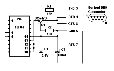

To eliminate the problem being associated with the usb/ser convertor, try programming on a normal pc with a std com port.
I dont belive that the usb port can deliver the same signals that a serial port can.
I tried with my friend's laptop it is also not working.
Is their anything i should take note?
I wouldnt bother pursuing the Q&D method, if you cant get it to work, build a proper programmer like this one:
**broken link removed** which does work.....I've built several. All work first time.Search the board there's a pcb layout on here somewhere that I posted a while back.
The easypic schematic is wrong if you compare it with the newpic circuit. I think the cathode pin of D1 and the + end of C1 should be connected to the other end of R2 at the base pin of Q1.

Guys thanks for your help.
I tried both the programmers and it worked.
The 1 resistor also worked but my serial port do not produce enough voltage (4-6V) I added a 9v battery and it works.
