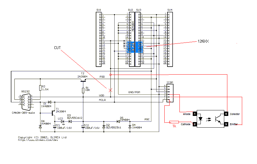

I have a JDM type programmer, and did a "NO NO!" with a pic12f629 chip ( int osc / mclr off )! I can see that the code is trying to run whin I place a chip into the programmer. (dim flashing led ) The Chip will not erase now.
I now know that I must turn on vpp before vdd. Witch a JDM programmer cannot do without mods.
I thinking that the mod in the attach should work !
Is it worth a shot ?
thanks,
steve
