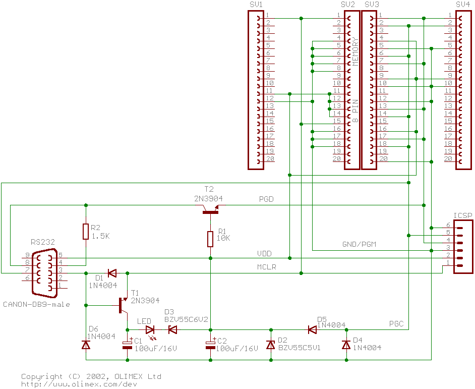

I have built a JDM style serial programmer using an external power supply to power the pic. I have read the datasheet for the 16F628A and to enter LVP I have to pull MCLR and PGM to high. RB7 is hooked to pin 4 & 8 of the serial port. PGM is to pin 3 with a 10k resistor. If I wanted to use HVP could I not pull PGM high and use 13+ volts to MCLR?

I took this from the datasheet of the 16f628A. So far the JDM programmer I built isnt working. According to this schematic it should have power to Vss and Vdd.
Pin 3 of db9 to RB7
Vpp to MCLR ;which right now it is a 10k resister to Vdd
GND to Vss and Pin 5 on db9
Just to check, which db9 pin does RB6 connect to?
Should the +5 be from any of the db9 pins or can I use the external ps?
I could use all of the help I can get!

Try this, I build it myself and it works fine with Ic-prog. I didn't assemble the sockets, I just use ICSP and I have a jumper to select power (from serial port or programmed circuit)

After studying the schem from the datasheet it shows data i/o (pin 3 of serial) to RB7. And CLK to RB6. But it doesnt say anything about PGM.
The schem for the LVP cable on Stoltz site shows DATA line 3 to PGM and other pins to RB6/7.
Should I just pull MCLR and PGM high off of Vdd and put pin 3 to RB7? What pin on the serial port is CLK?
Okay I have tried two different JDM programming software and it keeps failing. I brought the cable length under 6 inches and used a meter to test all connections.
MCLR is pulled high off of Vdd with a 10k resistor.
Vdd = 5.0+ VDC ;external PS
Vss = 0+ GND from ps and to pin 5 of serial port
PGM = pin 3 with 10k resistor
PGC = pin 7 with 10k
PGD = Pin 4 w/10k & pin 8 wo/resister
Anythoughts?

I am trying to use LVP. Other then the LVP check box on the ICProg is there anything else I need to do? Sorry I am really new to programmers.
I just read a tutorial with another JDM style programmer using ICProg and it talks about WinXP needing special drivers. I never installed those. Could that have anything to do with it?
The configuration word in the PICs memory has to alredy be set to LVP.Then You need to aply a logical high to bouth MCRL and LVP and giving it power suply to Vdd and Vss. Then the programer can start comunicating whith the PIC
While I am hitting my head on the wall because it isnt working I had to ask this. Could the fact that my serial port runs with -11 volts have anything to do with it? Do I need to use a MAX232?
