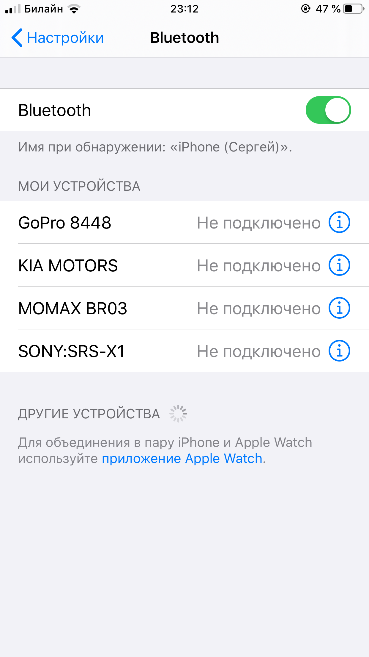

Please somebody help me. My JDY-10 displayed in HM10 Bluetooth Serial Lite and successfully connected, but in iPhone Bluetooth settings only displayed when connected (device name JDY-10-v2.4). When connection closed JDY-10 don't displayed in iPhone settings.

Thank you for reply! But there is no problem connecting to JDY-10, the question is why JDY-10-v2.4 does not appear in the Bluetooth settings on the iPhone.

Off hand, If it is not advertising, iPhone will not see it. I assume that your iPhone has seen it before - right?
When it is connected, it is not advertising, of course. But, when it *thinks* it is connected, (even though you know better) it will not be advertising. It will also not be advertising if it has crashed somewhere along the line. That is my off hand guess what is going on.

iPhone sees JDY-10-v2.4 only when the connection is already established. As I understand it, JDY-10 should advertise itself.

BTLE (Low Energy) devices do not "connect" the same way as other bluetooth devices.
The connection is created on-the-fly as needed and then dropped again - that's why apps such as the terminal programs can connect and communicate, but there is no connectable device in a conventional bluetooth scan.

I'm not sure that I can be of much help, but the point I was trying to make is that if you set it up as a Central device, then it is not going to be advertising, it is going to be looking for other devices (peripherals) to find and connect to. That may be what you are experiencing, but I am not sure.
