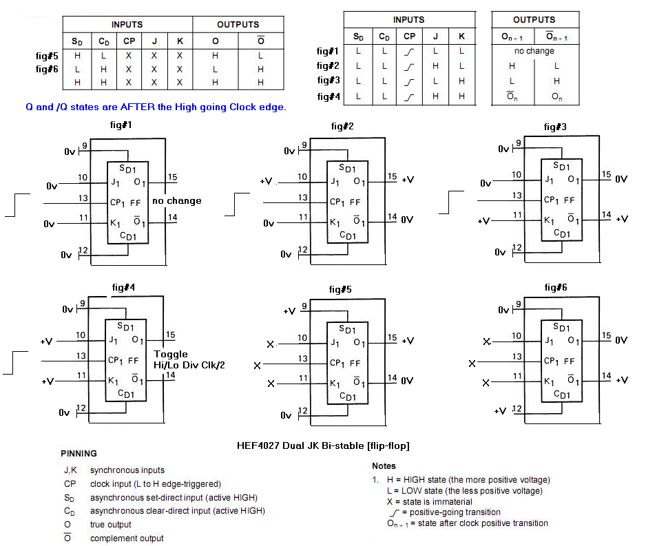

hi Krissie,
This is a composite image of the 4027 states which I did a while ago for another OP, it may help you understand the 4027.:)
The simple rule that so many newbies fail to follow is "Let NO CMOS inputs float". Otherwise you are just about guaranteed erratic operation. This includes the push-button which requires a resistor to ground (besides needing debounce).
Your transistor should have a base resistor to limit its current.
