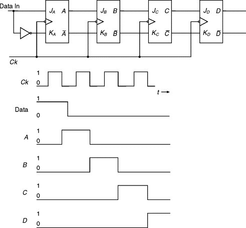

Figure A of Question 6 shows a diagram of a circuit made up of JK FLIP FLOPS components, which respond to the
.decrease of each CLOCK
For the SI input, the DATA information signal, shown in Figure B, is provided .
Assume that at time T = 0
Q1 = Q2 = Q3=0.
A. Indicate the purpose of the circuit shown in Figure A.(In the file attached).
B. Indicate a possible use of the circuit shown in Figure A.
Thanks a lot

So can you drew the right waveforms of Q1;Q2; and Q3?
In all cases j1=j2=j3=1
and k1=k2=k3=0
so q should be high.
Why am I wrong?
j=1 and k=0 is reset and not setup up as you said.
thanks a lot
There is no point someone drawing it if you do not understand why they work as they do.
The clock edge is an instantaneous event.
At that instant, J is high (and K low) for the first stage only.
It's Q [Q1] changes after the clock edge; it is cause-and-effect; the effect cannot take place until after the cause has.
You were correct with the modified sketch.
Q (and /Q) change immediately after the clock edge; typically a few nanosecond in real devices.
The J & K (or D for D type) inputs need to be valid for typically a few nanoseconds before the clock edge, to be accepted.
So, the input data is shifted through one stage per clock pulse; that's what a "shift register" does:
You changed the DATA something that is is not allowed to do.
I drew only q1 q2 and q3.
Your own PDF (second one) is showing the same effect, the input data is being shifted by each stage as it is clocked. Just happens you have 3 stages instead of 4 as shown by RJen. Number of stages is irrelevant, it is the concept of shifting that is being shown.
That is a diagram showing how a shift register works, using JK type flip flops.
It's not an answer to your homework, it's education; the data at the input (whatever it is) will move one stage along with each clock cycle.
More examples:
Why not? Is that a realistic occurrence in a real system? What would be the point in filling up a register with either 1's or 0's and not letting the input change. Where did you acquire such a quaint notion?
