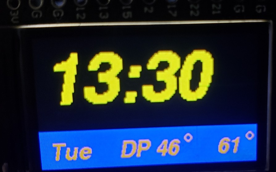

Here's a picture of what I an working on at the moment to get some understanding of C++ (the language Arduinos use). This is the $7 module I showed above with a tiny but sharp LCD built-in. It's displaying the time and day of the week, gotten via an NTP server (Network Time Protocol) using wifi access to the web. In the center of the bottom, it's showing the current dewpoint and outdoor temperature obtained from OpenWeatherMaps, also via the web.
The large font looks a bit jaggy in this picture because it's larger than life size. I used a font that's scaled up by 2× to fit the screen, so it's a little blocky but at normal viewing distance it looks good.
If you'd actually read what I posted about the board I made, it's for connecting an ESP32 module (without a built-in display) to a larger display with connections for external sensors and devices.

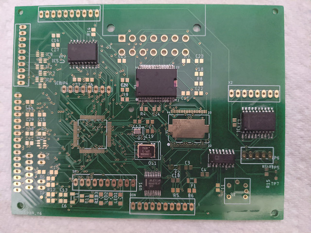

BTW, I'm currently trying to use the PCB software with the hope to get assembled boards. I may be back with questions.
I think you'll find EasyEDA pretty simple to use.
Key point: when designing a board for JLC to assemble, select parts from the "JLC Assembled" category and look for "SMT Type: Basic". These are the parts always loaded on the pick & place machines. "SMT Type: Extended" must be loaded into a pick & place machine to make your boards. I think there's a $3 fee to load each extended part on to the p&p machine and there is some limit on the number of extended parts you may use.
If a component is not in the "JLC Assembled" list, that position on the board will not be populated.
I'm unlikely to use their assemble service but the ENIG-RoHS plated board quality is good but not super cheap once the extra charges and shipping are included.
