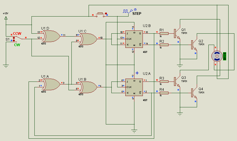

I need the following schematic:
https://www.aaroncake.net/circuits/stepper.gif
Converted to eagle such that i can send off the gerber files to a PCB house.

Is S1 a switch? Have you tried this? Don't you get switch bounce? (multiple steps if the switch does not close cleanly)
The switch only connects through to the JK inputs; the state of these doesn't affect the output until the flipflop is clocked (via the STEP line).

Hi Shane,
I simulated the circuit and it works fine.
Free wheeling diodes are omitted since the circuit simulator won't produce any back EMF. :D
If you use remote signals for step and direction make sure the connected IC always "see" some level at their inputs (U1, pin12 and pin6) as well as U2 pins3 and 13.
I suggest to use pull down resistors for a defined level at the mentioned input pins.

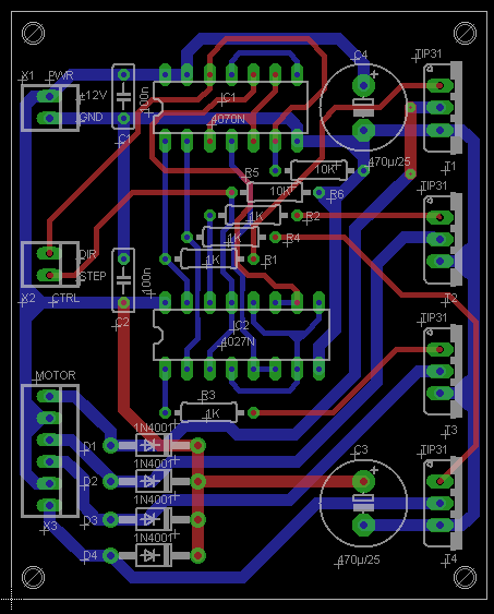

Here is a PCB suggestion.
It contains everything you requested + pulldown resistors.
If they are not needed just don't use them.
Boncuk

The board looks good! Would need the power moved away from the step/direction as I worry about the noise.
Could the board be made smaller? Also I think the caps are a nice addition. I had a couple of caps on my breadboard originally because my power/noisy breadboard where suspect but now that you did this I realize the draw on a stepper is large and it is safer to go this route.

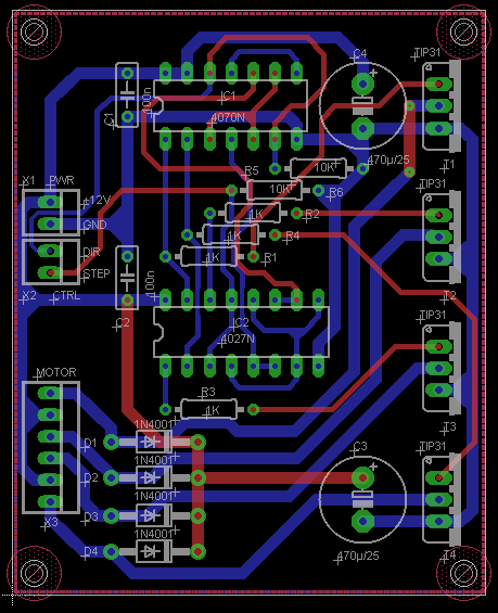

Hi Shane,
of course could the board be made smaller. I just kept a minimum distance between power transistors (out of experience) for optimum cooling.
The power connector has been moved North.
Boncuk

This design looks perfect. I see the pull downs on the inputs with the 2 10k resistors which is a great suggestion along with the caps as well as the movement of the step/direction connector.
When you post the eagle files I'm going to send for a small batch of boards probably using batchpcb.com. It's a low cost way to get a few boards. $10 + $2.50 per inch^2 or there abouts.

Hi Boncuk,
Nice board!
Could you explain the theory behind the C3 and C4 capacitors? Are these decoupling capacitors like the 2 other ones? Wy this size and wy 2 instead of 1 or 4?
Thanks!
Alain

Final files
As promised - here are the Schematics and PCB layout provided by Boncuk. They are in the public domain free for anyone to use.
Well I got a couple of boards made. Put it together and of course it doesn't work :( I'm hopefully just tired and missing something obvious. However all the output signals remain fixed. I spent a fair amount of time checking the traces and everything appears to be fine. I did continuity checks as well on a bunch of traces looking for bad solder joints.
Any suggestions?
