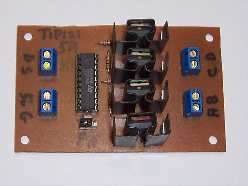

As stated in your post, I think that ou are using TIP131, not TIP31 (or are you??). TIP131 is a Darlington transistor and, as far as I know, is very easy to turn on. I may be wrong but I think your problem is not there.
This simple driver provide a full step sequence, that is there is always 2 transistors on at the same time even when the motor is stopped. That is probably when the transistors are heating up, when the motor is stopped.
I have many drivers using TIP121 and they are equiped with small heatsinks. I also use a fan but just for peace of mind. It is not really required. The TIP121 is rated at 5 Amp. I use them with motors rated at 1.5 Amp.
One thing about the TIPXXX transistor is that they are very rugged compare to MOSFETS. The mosfets don't forgive mistakes.
Alain

I dont have a schematic for my circuit. I just drew it on a piece of paper before drawing the PCB using FreePCB software. It is a circuit even easier to make than yours. The chip is a L297 that can be used to provide half or full step sequence to an unipolar (like my board) or bipolar stepper motor. But for your boards, I would simply change the TIP31 with TIP121 or TIP131. For the heatsink, there is some special mica parts that are used to isolate each transistor before fixing them to a commun heatsink.
As I said, this is a simple circuit and, providing the proper voltage to the motors, you can expect something like 300 RPM, this is with a good usable torque. Not very fast but still you can do a lot of things with that.

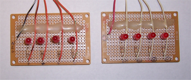

Here is a picture of 2 testers that I made to help understand what is going on when working on these kind of circuits. You should build some too if you don't have something similar. This is a tool that I use quite often.
You should check that the logic is working properly before testing the power stage. Be sure that the arduino is sending the good sequence, some highs and some lows, no floating. Then the logic sequence. It should be:
XX00
0XX0
00XX
X00X
The leds tester is very handy to visualize that.
Then you can start to work on the power stage. I don't thing that the pin compatibility is your problem.
