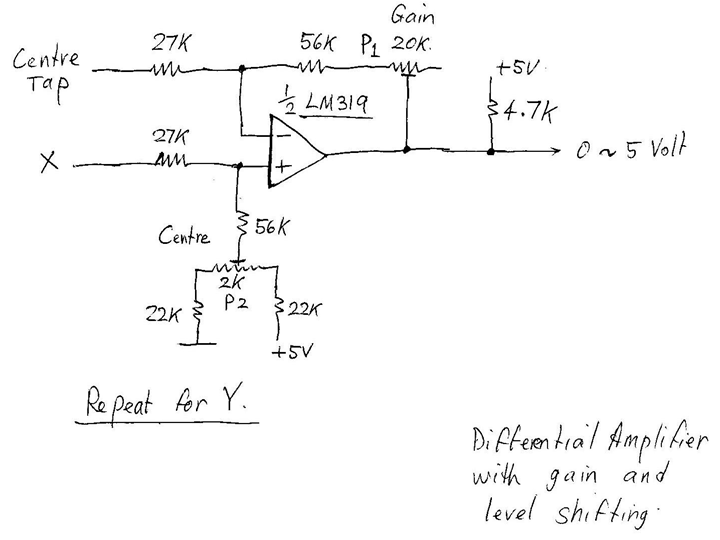

Here is the way I would do it.
The LM319 is a dual voltage comparitor but I'm using it as an op amp inorder to restrict the output to 0 ~ 5 Volt.
Do you have the electronic construction and testing skills necessary?
If not, I can guide you through it.

I'm helping twinforced by email, but I find that the attached JoyStick data sheet is ambiguous in some areas.
Under the heading Order Code / Voltage Swing 1, 2 & 3 it states:-
Input Voltage Vs 10V, 12V, 12V
Output voltage swing +/-10% Vs, +/-8.3% Vs or +/-10% Vs
But on the next page, under Specifications / Electrical it states:-
Supply Voltage Vs Range 0-8V, 0-10V, or 0-12V Maximum 14Vdc
Output Voltage Swing +/-10% Vs, +/-8.3% Vs with respect to the centre tap
Error Signal >+/-25% Vs
Centre Tap Voltage 50% Vs +/-1%
I've coloured the conflicts.
Red - Obviously Vs is the supply voltage, not the Input Voltage.
Green - One states 10, 12, 12 & the other 8, 10, 12. ??
And what do they mean by eg. 0-8V? Obviously, this can't be a range as the unit can't operate with a supply voltage of 0V, so they must mean that the red wire is connected to +8V and the black to 0V.
Blue - Why 3 in one case and 2 in the other?
What do they mean by "Error Signal"?
I'm happy with the Centre Tap Voltage.
For example, if you use Vs = 10 Volt, then 10% of Vs is 1 Volt. The centre tap voltage is nominally 5 Volt, so the output of the JS will change from 5 Volt to 6 Volt (continuously) when the JS is moved one way (say +X) and from 5 Volt to 4 Volt when it is moved the other way (ie. -X).
The Y axis is the same, ie. 4 Volt +Y, 6 Volt, -Y.
Any advice will be appreciated.
