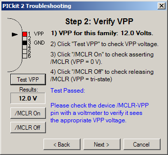

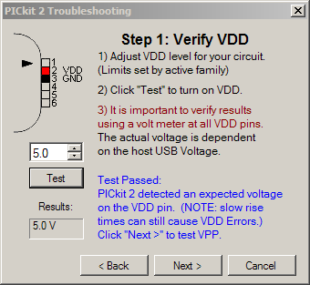

I have built the programmer part of the Junbug from the schematics. The software reports a short on the VPP line when testing. I will try replacing the sip resistors (I used discrete) with the values from the parts list where they do not agree. The again, it could be a real short and I have yet to find it.
For others building the board. The PK2 software on the PC. From the main menu do TOOLS>Troubleshoot.. This will allow you to test the analog circuits between the PIC and the target. Even generates a 30KHz signal on the clock and data lines so you can look at it with a scope. It is good stuff and I wish they had included it for the ICD2.

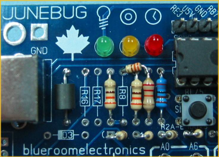

Here's some photo's of my working Junebug as PK2.
Note: I've used BC548/557 transistors so they're fitted the opposite way to the overlay. Also used a 470uH inductor and discrete 1/8 watt resistors in place of the SIP resistors.
One other thing I've noticed on the Junebug.
On the schematics for the Microchip PICkit2 the Target Power LED connects to +5V; on the Junebug it connects to Gnd.
This makes the Target Power LED on the Junebug work with reverse logic i.e. Off when Target is powered, On when it's not.
Fit the LED the opposite way and connect the 330R resistor to the top of R15 (+5V). Here's a photo of my quick fix. (if you've already assembled it I would cut the leads off R8 rather than trying to remove it and be very careful not to lift the PCB tracks reversing the LED)

The Target LED works but is reverse of a PICkit 2. I used the prototype design when testing the layout and switched the anode at the last minute. It doesn't affect operation so I left it.

Both the SIPs and resistors will function the same, justs looks a little funky. The resistor values are marked on the PCB for the SIPs. The short could be the VPP cap is too low a voltage (16V, 22uf) make sure the DIP switch is off for testing. You can measure VPP on the ICD connector, there is a large gnd hole that will fit most meter probes in the upper left of the PCB. My VPP measures in at 12.1V

As I mentioned earlier I am building my JuneBug in three steps. It was tested at the end of each step prior to going on to the next.
1. Get the 18F2550 talking to the PK2 interface. (done - OK)
2. Add the analog parts to allow it to program debug. (done- OK)

None that were real. All the parts had the correct pinouts :) and construction was straight forward. I made a few minor blunders along the way like testing VPP with my DVM on AC:rolleyes:. But the O-Scope showed it to be correct, only noticed that the DVM was on AC after I started writting this..
Earlier I posted about a problem with a VPP short. I should clarify that that was not with a real JuneBug PCB. Prior to getting the JuneBug PCB from Bill I had started construction on a JuneBug Clone without the tutor.
