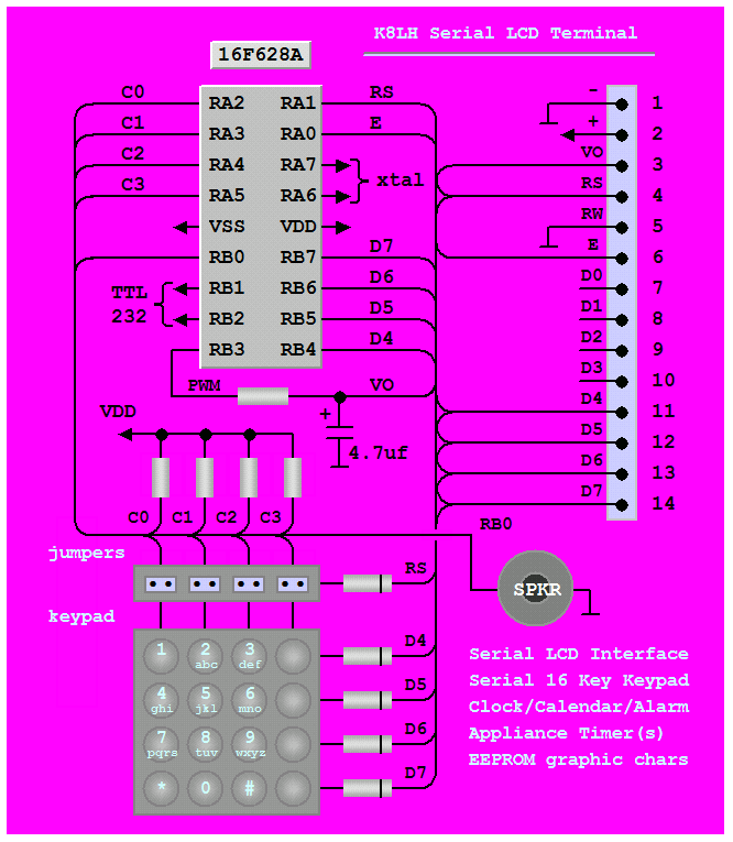

Well I was working on a side project that has a small breadboard, a 40pin PIC (a few choices), 20MHz crystal (deselectable), USB optional, keypad / LCD using up ports D & E
What type of LCD? 4 or 8 pin interface? What type of keypad? If it would help I could show you how I use 12 pins for a 44780 type LCD using the 4 pin interface mode, PWM contrast control, 16 key keypad, and piezo speaker for switch press beep.
Mike
It was 4 bit, the trick was to only use port D & E (11bits) for both a 4x4 keypad & an LCD. 7 for the LCD + 4 for the keypad (using 4bits from the LCD too)
Of course I'd like to see your design Mike, that's a lot of stuff for only 12pins.
Bill,
Forgive me. I thought you were using up 16 pins but if you're doin' all that with 11 pins then there's no new tricks I can share -- you're already a 'Master'... I'll attach the diagram anyway for anyone who'd care to take a look.
Regards, Mike

The RS pin as an input is pretty neat :) and you Mike are the master of streching I/O.
I did have the LCD RW pin supported, I could put a jumper for a buzzer there...
Edit: would a 4x4 keypad or a 3x4 with 4 LEDs be more interesting?
Edit2: The Junebug / PK2 have a very handy UART mode... So goodbye serial port, it will have a USB connector.
