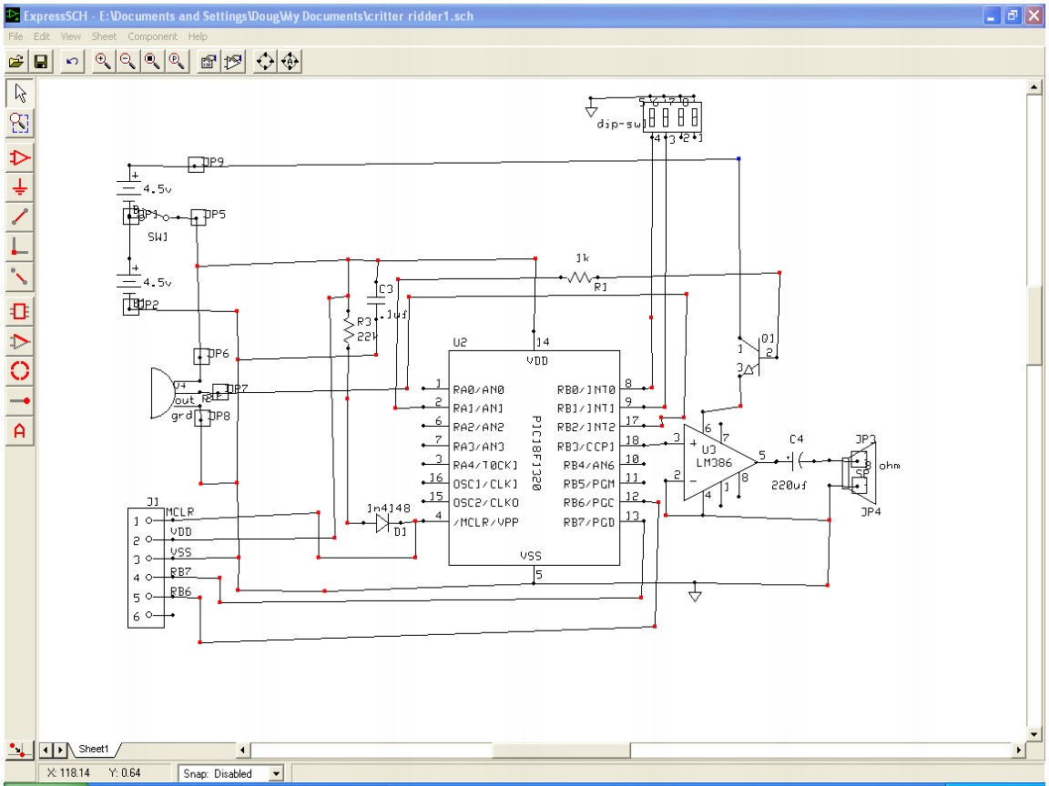

havn't got something right??
can I add 2 more variables for speed depending on dip switch settings?
revised schematic but portb.1??
had to change connections on the amp transistor. this works
now trying to input the variable=speed to change the delayMS
tried going to ground with pin 9 (portrb1) but it doesn't change.
I inserted 25 in the delayms(25) (had delayms(speed)but it didn't work) and it runs much faster with 25 as delayms but I want to control speed using the dip switches.have 4 so dip1=100, dip 2 = 150, dip 3 = 25, dip 4 = 250 or what ever values I want.

any suggestions?
dip switch settings on Junebug using the USB to power project??
I guess what you are trying to do is,
WHILE(TRUE) 			//repeat forever
    if PORTB.1=0 then
        speed=25
    else
        speed=200
    endif
    IF PORTB.2=0 THEN 		//if PIR activated portRB2 is low
        FOR i = 1 TO 200 	//play 20 tones
            Tone=Rand(5) 	//each tone is random frequency
            DELAYMS(speed) 	//and for 25-200 seconds here is where I want to change
        NEXT 			//end for loop
    ELSE 			//otherwise
        Tone=5 			//silence
        i=Rand(255) 		//make rand more random
    ENDIF 			//end if condition
WEND 				//end of while loop
Edit, you don't want the transistor on the positive side of the amp or the amp will only get 4.7V. It needs to be in the ground connection.
Thanks Pommie will give it a try
I tried the transistor on the ground side and got what sounded like static as well as the desired tones.
I am going to reconnect the amp pin 4 to collector only (I had pin 2 and the speaker ground tied in as well but going straight to ground with pins 2 and speaker ground only.
hopfully I can add some more variables to the speed
YES but trying to add more to it
I added your p[osted code and it worked.
I moved the transistor to the ground side of amp and powered the base using porta.1 (inserted a toggle(amp) and it works. need to recaculate the base resistor as the port only shows 2.5v

adding, cutting pasting etc but??
wonder if something like this?
if PORTa.0=0 then
speed=50
port a1=0 speed +50 // a dip switch setting
porta0=0 speed+75
port a2 = 0 speed +100
speed=25
endif
not real sure of syntax but ?? add 50 or so to speed per switch setting
What about ADC for the variable? of dip sw.
I have been kinda reading and ran across ADC inputs for a PIC.
Wonder if putting 4 resistors in series then have the 4 pos dip switch select the different dip switches thus producing 16 different voltages?? instead of using 4 different ports??
keep getting errors??
thought I would try using variable arrays. keeps asking for next or end expected??
then subroutine out of bounds?
DEVICE = 18F1320
CLOCK = 8 // 8MHz clock
CONFIG OSC = INTIO2, WDT = OFF, LVP = OFF
DIM NOT_RBPU AS INTCON2.7
DIM TMR1IE AS PIE1.0
DIM TMR1IF AS PIR1.0
DIM TMR1 AS TMR1L.AsWord
DIM Speaker AS PORTB.3
DIM SpeakerTris AS TRISB.3
DIM Amp AS PORTA.1 // turns on amp power
DIM AmpTris AS TRISA.1
DIM dip1 AS PORTa.1
any suggestions???
totally lost again
trying to make each dip switch equal a set value using an array.
well can't get it to work??
any help
Const
dim speed(4) as byte=(25,40,55,70)
      for speed = 0 to bound(4)
      if dip1=1 then speed(1)  //dip switch values
      if dip2=1 then speed(2)
      if dip3=1 then speed(3)
      if dip4=1 then speed(4)
      speed()=speed(1+2+3+4)
end
You need to find a good tutorial on Basic. The code you keep posting is, how can I put this politely, rubbish.
Try to understand how each command works. While always has to have a Wend, If anyways endif, for always next etc.
Try to get an understanding of program flow and this stuff will be really easy.

I have to agree w/Pommie=rubish but
I am chipping away at it.
I keep getting then statement errors.
am making progress. a little but some
will ask for suggestions and then I hopfully can change to fit my preferences,.
I presently have Pommies code intermixed with be80be's
have one version that works but it shows a hint that I declared something but didn't use it.
had several on one version and discovered I had an end statement that wasn't supposed to be there.
YES I would love to find a good book that describes all the syntax.
Unused declarations aren't bad, just means once you get things to the point it works go over it with a fine tooth comb from top to bottom and correct things neaten things up and comment as much as possible. If you don't comment your code judiciously in a few months you'll go back to that same code and have no idea what it does =)
MrDeb, what language is this in again?
