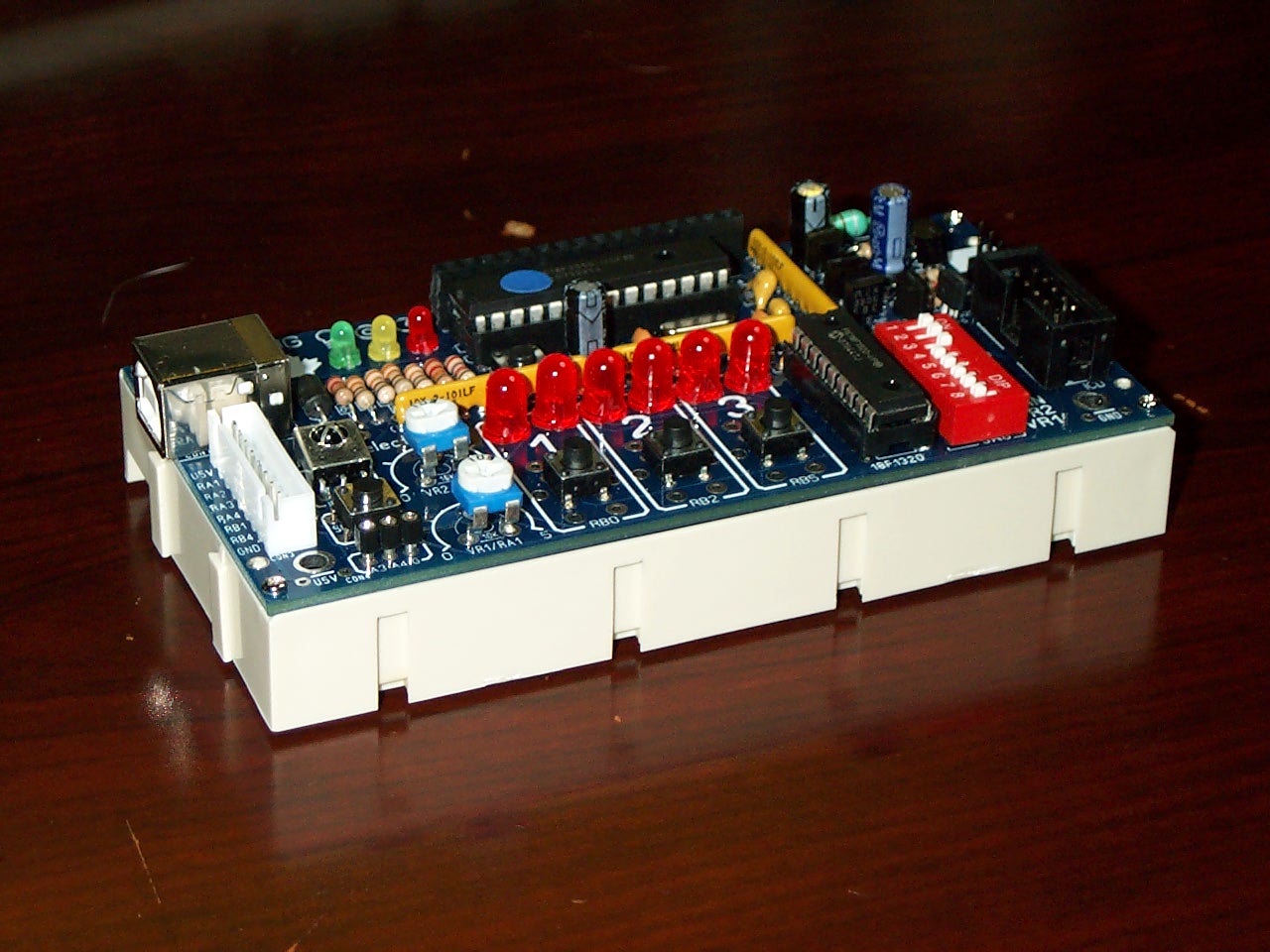

Here's a picture of my JuneBug in a Lab-Easy box -- a very nice product.
