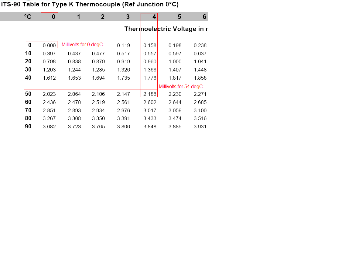

If I understand your problem with the numbers 0 to 10, it is as follows:
To find the TC output for 54 degC,
look down the degC column at the left hand side until you get to 50,
then look across until you get to the column headed 4 degC
the reading at the junction of the 50 deg Row and the 4 deg Column is the millivolts for 54 degC.
See the attached piccy.
Ahh, that makes sense. I feel kind of silly for not realising that now. :eek:
Thank you for your help.
