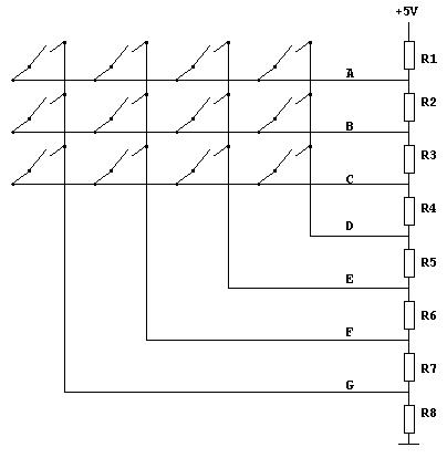

would this work...?

Hi exo,
You can read the voltage of the R8 for example.
Problem with the previous circuit is that multiple keys pressed at
once would not be detected. For example upper left key (A-G) would
short most of the network and any other key would not be detected.
Also circuit would continuously draw current.

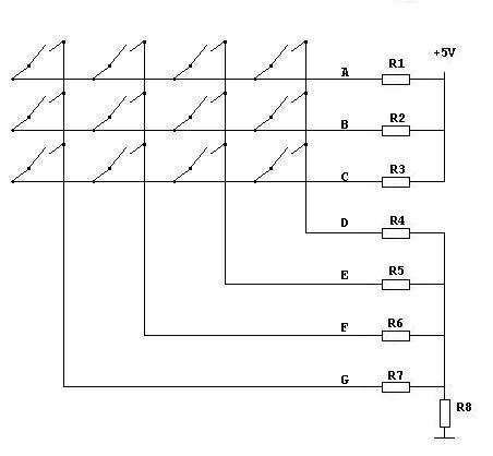

After some thinking I came up with another circuit which should be better.
Yep, that should work.
I'd recommend ratio for the R1-R7 values 1:2:3:4:4:8:12
For example
R1=100
R2=200
R3=300
R4=400
R5=400
R6=800
R7=1200
Resistor R8 is load and for good results it should be much bigger than
the other resistors if you want really linear system (the best would be to use constand current instead of fixed 5V source). I calculated things over using 10k for R8 and that looked very good. The output signal in this case
is only few mV and needs to be amplified of course.
Using lower value does work as well, it's just that graph is slightly bent. Values similar to R7 should be acceptable. Lower R8 also provides for larger output change. Anyway, it's an idea... use it on your own risk
:lol: :lol: :lol:

BTW, I got my circuits working now... esp. ADC part...

The keypad resistor network really great and I have my code working with proper keypad mapping. The PIC code can detect what appropriate keys you press..
