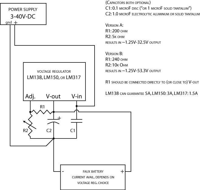

What say ye about this schematic? I don't want to give you the impression that i know what i'm doing or anything, but this seems to fit the bill...
I assumed that an LM317 qualifies as a low-noise voltage regulator... I actually ordered a LM150 (not cheap, eh?) just to have the option of higher current outputs.
This schematic was largely based on this project: Replace the battery on a desktop gadget with USB power
The idea here is to have a tunable voltage so I can simulate one battery, two, etc.
Here's a question, though: some devices use multiple batteries in parallel, no? E.g. I can pull one of two batteries out and the device still works. Is there some easy way to figure that out, per device, so I can present it with the proper voltage and fake-battery rigging? I guess I can always do just that: take one battery out and see if it still runs (on a single fresh battery)...
Thanks!
-c

The instructable and the last circuit are wrong.
The important capacitors are missing (they are not optional) and the value of R1 is too high. R1 must be 120 ohms for an LM317. A more expensive LM117 can use 240 ohms. When the value of R1 is too high then the output voltage rises when the load current is low.
Aha... I'm very uninformed here, but, doesn't:
https://www.electro-tech-online.com/custompdfs/2009/06/LM117.pdf
...show (on page 21, using an LM317) an example of using a 240 ohm R1? Maybe "Rs" changes the game in that schematic...
In general, doesn't the equation apply?: 1.25*(1+R2/R1) ? The PDF just doesn't seem to mention anything about 120 (although it pops up in one schematic), but of course I'm more likely to listen to a real person over a PDF. :-)
Or maybe what you're talking about is the ground-level reality of using these things as opposed to the graphs in the spec... or at least the ground-level reality of using these in low-current load situations.
Did i get the capacitors right in my schematic? They are referred to as optional in the PDF a couple times, but maybe that's a generous "optional"?
I have an LM150 coming in... 240-ohm R1 appropriate for that?
Thanks for setting me straight!
-c
The minimum load current for an LM317, LM338 and LM350 is 10mA. When R1 is 120 ohms then its current is 1.25V/120 ohms= 10.4mA. It provides enough load current without any other load.
The minimum load current for the more expensive LM117, LM138 and LM150 is 5mA so the value of R1 can be as high as 240 ohms.
The battery charger uses 240 ohms for an LM317 because there is always a load current that is enough to hold down the output voltage.
Page 8 of the datasheet for the LM317 describes the output voltage rising when the load current is not high enough.

Ok, thanks for the info. This all is clearly beyond my partial understanding of the situation. but I understand what you're saying.
So, do I infer that I need at least 5mA drawing on the output side of my LM150 for the voltage to be appropriate? It would seem that this would then be an inappropriate circuit to simulate a 1.5v single AA battery or 3V with two of them in series, given that most devices are going to pull a lot less than that 5A (given what a previous poster wrote)?
Further, will I be able to test the output voltage with a multimeter to "tune" R2 if the output is unloaded, and if not, will I be able to tune the circuit accurately at all?
Thanks again,
-c
The 120 ohm resistor takes care of the loading. The load current with a 120 ohm resistor is 1.25/120 = 10mA, which is fine.
Yes, use a multimeter to set the output voltage. It will be accurate.

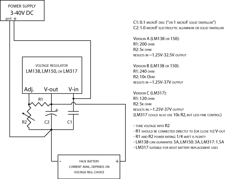

Super. Thanks all... here's the latest "corrected" schematic. I'll post a celebratory note when I'm done. :-)
-c

I think the value of your pots are too high.
1) Version B. R1= 240 ohms, R2= 10k ohms. When the pot is at max setting then the output will try to be 52.3V.
2) Version C. R1= 120 ohms, R2= 5k ohms. When the pot is at max setting then the output will try to be 53.3V.
What about heat? If the input is 40V and the output is set to 5V then with a load current of only 0.5A the IC will heat with 17.5W and even if the heatsink is huge the IC might shut-down.
The LM317 will reduce its max current to about 175ma to 500mA when it has 35V across it.
The LM150 will reduce its max current to 275mA to 1A when it has 35V across it.

Yeah, I had come up with those numbers too, but since the data sheet said "The LM117 series of adjustable 3-terminal positive voltage regulators is capable of supplying in excess of 1.5A over a 1.2V to 37V output range" so I assumed there was some other limit coming in to play... But I see your point. Smaller pots would make more sense.
Duly noted. My intended application is coming from DC converters, so theoretically most are going to be 5-12V kinds of values... I just wanted a little flexibility for weird cases. But if I understand things, the greater the V-in V-out differential, the harder and less efficiently the unit will work?
